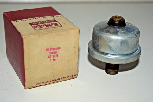

There's a NOS 50 LB sender on eBay right now, eBay item number:147032870427.
Bob Selzam is the seller, and his stuff is always good. Price is $159 but I've seen them bring more.
35-42 Ford Mercury 50LB oil sending unit NOS 36-48 Lincoln 37 38 39 40 41 1942Opens in a new window or tab

Those NOS 50 LB senders have been really scarce for a long time. When I was doing my 42 Ford project, I really needed a 21A-6312 crankshaft pulley which was holding up the whole project. None of the usual suspects had one. I'd be embarrassed to say what I paid for the one I did find. I was going to paint it gold for what I paid! It balances out. Some things cost next to nothing and others you wanted to puke but you needed the part. The aftermarket is reasonable but if it doesn't work not a good deal.

Update #2
I have installed a 50 lb. oil pressure sender from Kaiser Willys Auto Supply, part number 800807 using a 1/4" NPT to 1/8" NPT reducer bushing.
The gauge is working properly now.
