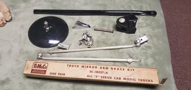

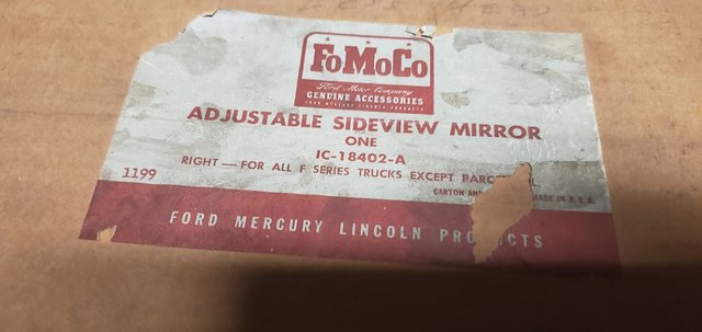

Resurrecting an old thread for the same problem, but now the original ones appear to be discontinued.
Looking for an original style LH door mirror for a 1952 Canadian F1, which is already in paint, so grinding the hinge is not high on my list, can anyone suggest where to look for a good used one? Any help would be most appreciated!
File Type: jpg 4471AD62-7E5D-4A9D-9469-FB510F5E8D54.jpg (33.9 KB, 115 views)
File Type: jpg 8A1DF53A-D6FA-4B09-82D0-CF7F0AB28951.jpg (76.9 KB, 115 views)

I’m not sure, but I believe that the bracket that mounts on the hinge is the only side specific part of the assembly, and that the arms and mirror itself will work on either side. Would you consider parting with the assembly and I could either fabricate or continue searching for the bracket? ( I have the right side bracket, which was on the truck when I dragged it home, the LH one was missing)
Thanks,
Chris
1927Tudor is offline   Reply With Quote
Old 04-03-2023, 02:55 PM   #16
cjshaker
cjshaker's Avatar
Join Date: Jan 2023
Location: Ada OH
Posts: 201
Default Re: F1 mirrors
You're right in that the bracket is the only side specific piece. Sending you a PM.

I had located an original RH mirror for my F1 pickup. They are difficult to find as RH mirrors were an option used mostly on commercial vehicles. The one pictured has the correct clam shell for the hinge but the arm would have been shorter for a pickup, the one I had was extendable but without the support arms. They were reproduced at one time.....I would check with southsideobsolete.com to see if Fred has a NOS one.
Tim
