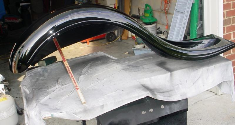

Don’t consider myself a particularly clever chap but do want to share a small trick that worked very well for me today. After painting the underside of a front fender was having trouble figuring how to hold it in such a way as to not scratch the bottom while painting the topside. Came up with a piece of wood stick/screw/washer through the headlight bar hole and block of wood under front inner edge of fender. Allowed me to get to all areas with gun without having to handle the fender.
The table is an old BBQ stand with wood slats mounted to top. Keeps things at waist height and great for rolling around garage/driveway for sanding/painting etc.
