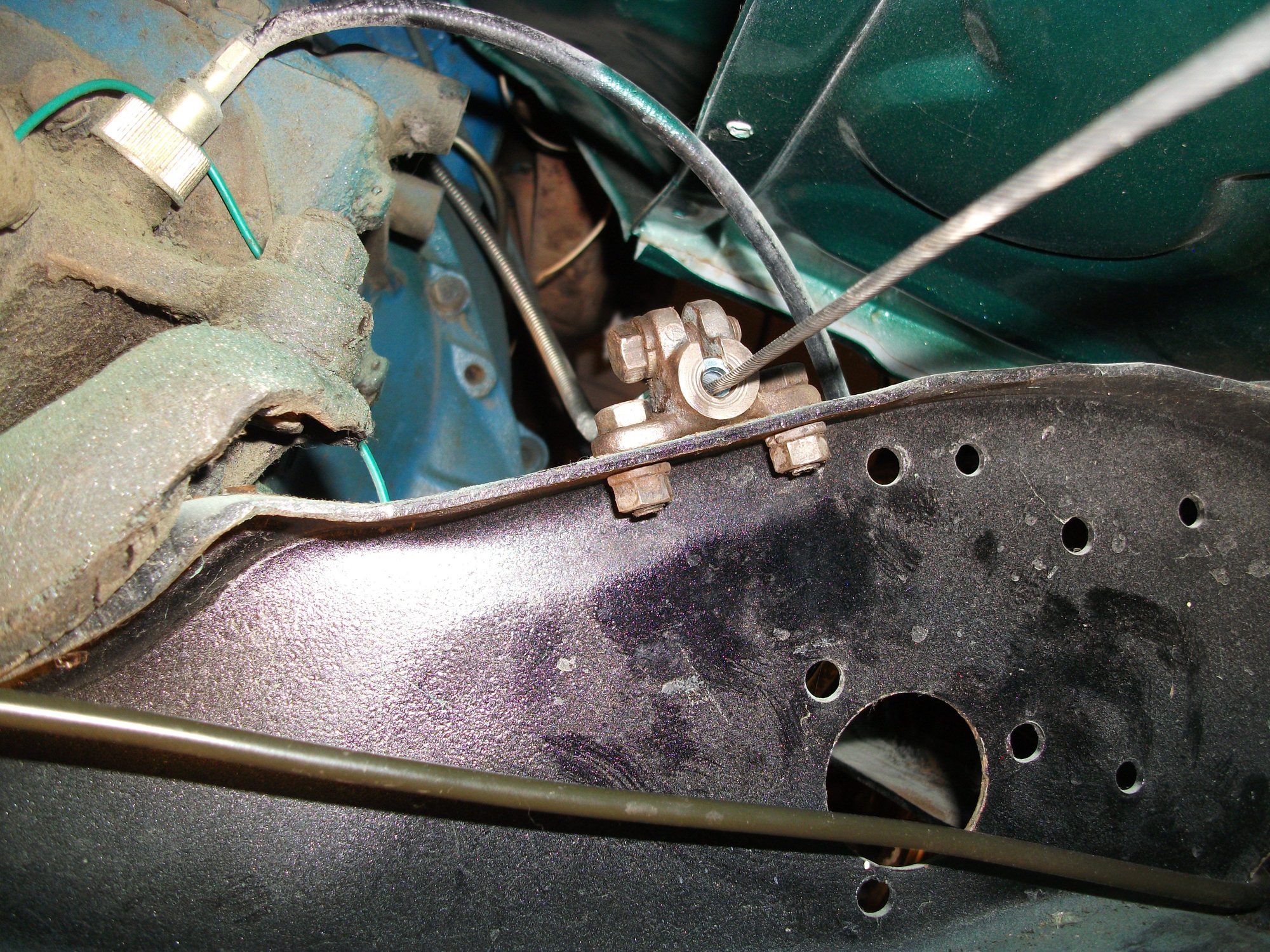

Seth, to answer your actual question, you know, about a truck, here's a photo that shows where it comes out of the cab. I can't at this moment find one from the inside. If my memory is correct, it comes out near the steering column.
I'll try to get a new photo asap.

Cable exits the cab just under the steering column, over the top of the bellhousing, to a clamp bolted to the top of the crossmember, on the passenger side.
