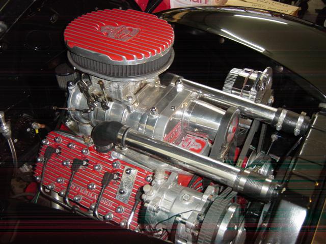

Here's a photo of an 8BA with crab distributor in my friend's 40 built by Mark Kirby (RIP) many years ago. It allowed for the installation of A/C compressor. I recall the cam had to be changed.

That engine looks like a earlier motor withe the water outlets in the center of the heads.
