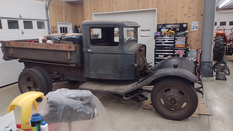

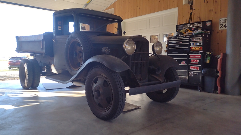

Mike,
Here is a shot of the 6.00-20 Firestones:
I can get close up if you need them:
I choose these only becasue that was what was on the truck when I got it.
Another consideration. The spare I put on only allows me to open the passenger door about 50%.

That makes sense I like your ideas, I think the 6.50 20 is a good choice great info Thanks

Thanks. My spare is in back. thanks for the info.......Mike Nice truck
