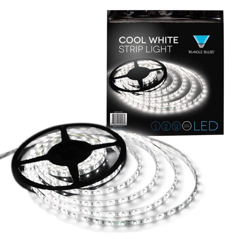

They make 12V LED strips that you could put under the dash rail. You can actually cut to lenght and then wire it up. Pretty nuts.

The LED tape is the way to go. Cheap, and easy to work with, and can be directly wired to a 12V power source. I used this for kitchen lighting under my new cabinets. It's probably one of your better options.
