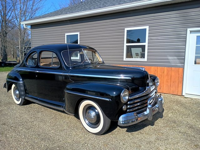

Ford folks,
Well I looked, but maybe not far enough? Tried to find a thread on John's 48 Ford.
He cruised up to the shop today in the nice 48.
Great to see it out in the sunshine! John spent most of the afternoon helping me improve the tail lights on my 65 Comet.

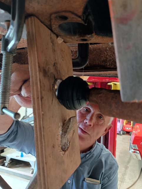

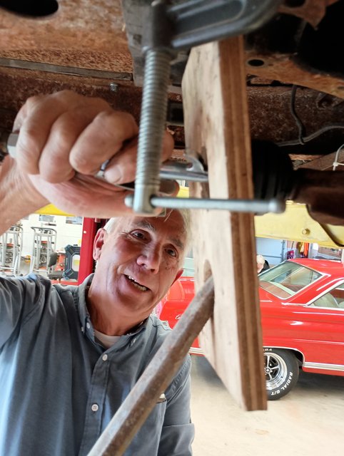

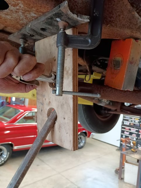

Its been a while! Keeping busy all summer. John wanted to change oil in his 42 and also replace the rubber ball on the rear of the wishbone.
We built some VERY crude tooling to install the rubber ball after John dropped the back of the wishbone. Clamped a couple pieces of steel above and below the frame "x" near the ball socket. This was to provide a "lip" to set the plywood against, to allow us to pry on the plywood. Cut a hole in a chunk of scrap plywood, then drilled another hole because it was in the wrong place. We used that lower hole to stick a rusty old crow bar in as a pry bar to push the plywood very firmly against the new rubber ball. ( Note the prior ball was a NOS and split when we tried to install it. Can't remember how we did that?) Then John applied 90 psi air to the hole in the rubber ball through the 1.25 dia access hole in the plywood. Seemed to work good. Oh yeah we put Dawn soap on the inside of the ball and also the knob on the wishbone.

I found an easy way to install the rubber ball on my 34 last week.
I tried all the usual tricks but still couldn’t get it on,
Finally , I cut two triangle shapes from .010 brass shim stock,the large end of the triangles was folded around the ball on the radius rod, the long end of the triangle ,about 2inches to the point was feed into the hole in the rubber ball,with a small smear of rubber grease on it.
Then I just pushed the ball up on the shim and it just fed itself onto the Ball leaving the shims behind, I couldn’t believe how easy it was, I had been at it for an hr before.

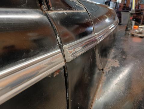

John had a small project on his 42 Ford "Cindy". He brought it up to the shop to look at the hood hinge or hood fit. The right side was sticking out and up at the back of the hood to cowl fit, and was high at the right side of the cowl also.
He moved the hinge a little. Friend Bill and his wife stopped in as John was into the hinge movement process. I got a call and was not able to help as they solved this fit issue. I was very surprised, but they did it. Seems with several of the hinge bolts loose Bill pushed up very firmly on the front of the hood and John tightened the bolts. This for some reason allowed the hood to fit Much Much better! John was happy! I was impressed!
Sorry I did not get any before pictures. But the hood stuck out maybe a 1/2 inch and up about a 1/4 inch.
look down the side
All good now!
