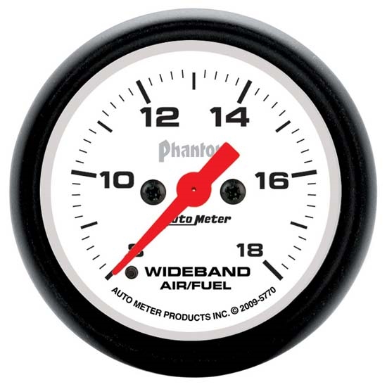

As my '51 Tudor project continues, I'm considering installing an A/F gauge to assist in tuning the new 276 engine with two 97's. I've read some conversation on this here in the past. Just wondering how helpful it really is. I have looked at the gauge offered by Auto Meter, and all of the exhaust parts are new on the shop floor, so welding the bung in the exhaust pipe would be easy. Sorry for rambling, any comments, recommendations most welcome. Thanks.

The AF meter is the only way toget the lean mixture to work. The ignition must have more advance to burn the lea mixture, but you still need a rich mixture for acceleration. All this can be done with one of Charlies distributors, and an Edelbrock 500 4 bl/
I was fortunate to ride in Richards Kunc 53 Ht withthe AF meter in my hand and watch the meter in the mid 15's in cruise.22mpg in a 276 l-100 engine. Impresive.

I use them for tuning on a variety of vehicles. Having one in the car is a big help - as you can see how it reacts under different load conditions. One thing to be aware of is WHERE you place the bung is important - usually on the upper-side of a pipe - at a slight angle. Think about a 10 - 11 o'clock or 1 - 2 o'clock position.
Also, it is imperative that you have NO exhaust leaks ahead of the O2 sensor - or you'll have the wrong readings. I usually want them 2 - 3 feet back from the exhaust ports.

I've been looking into A/F meters for awhile and finally decided on an Auometer 3379. It's a basic digital model but has leds in an arc above the numbers that make the readings easier to follow vs chasing an analog needle, imo.

That's the one.

That is the way to go so you can see exactly what the fuel ratio is under all driving conditions. From now on everything I build will have bung hole in the exhaust with a plug so I can hook one up for fine tuning.

YES, that is the one I'm leaning towards.

To prevent collection of liquids between the sensor housing and sensor element during the cold start phase, the installation angle should be inclined at least 10° from horizontal with the electrical connection upwards, see below.
