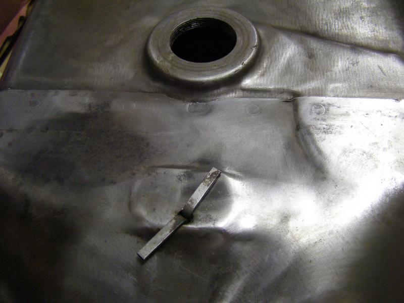

What purpose does this serve? Looks like a cotter pin installed in a hole in the bellhousing part of the oil pan on my 1940 v8
36 1/2 ton pickup
on 38 car frame

It keeps the hole from stopping up. That would let oil from the rear main get on the clutch plate and make it slip. All '48 back engines had this feature.

Scott, it is indeed a cotter pin, and its presence was Fords acknowlegement that Fords leaked oil. The cotter rattled to prevent the hole from getting clogged.

I think I'm confused. I have this same thing on my '35 (motor and trans I believe are out of a '46). What is the purpose of the hole?

It's an auxilliary oil drain hole. How else would you do it?

all early flatheads have it, i got one on my 35 motor

Make sure that cotter pin stays a little loosey goosey so it can jiggle around in that oil pan hole, otherwise, it can't do it's job. Old Henry knew what he was doing. He would never have wasted a cotter pin.

That was a consept used also in some early machinery oil passages before high detergent oils came along. It was called a "wiggle wire". It prevented sludge build up and blockage. That's why it's lose in the hole, it keeps wiggling while you driving, keeping the hole open.

When I started rebuilding my first flathead I saw that cotter pin and thought to myself "what kind of ill boggered job is this?". Then later finding out what it was for.
Have to admire all simple mechanical additions. Today there would be an electric/computer sensor that when faulty would cost $200 for the part. Cotter pin/1 part .50cents.

Don't you people use the search feature? I don't know why I have to repeat everything...sheesh:
Remember those old Murray Fahnestock manuals explaining Ford features in a Question and Answer format??
Here's my take:
Q. Why does the new Ford have a cotter key hanging out the bottom of the bell??
A. Its natural shaking as the car is driven ensures that the hole will not become blocked by dirt.
Q. Why is the hole there?
A. To allow oil leaking from the engine to drain out before it can get to the clutch frictions.
Q. Why does the oil leak so??
A. The leak is provided in order to prevent the formation of rust on the cotter pin.
So there. Skilled engineers design everything as a system.

Bruce's answer is the most logical , but stay tuned, as the cotter key is making a comeback in modern cars.
It seems that while cars no longer "high center" on deeply rutted roads, modern cars must contend with speed bumps, which results in "bottoming out" as bad as in the old days. The oil drain hole in both cases befowls with dirt & crud, for which problem the cotter key is employed to prevent.
Welcome back, Cotter!
