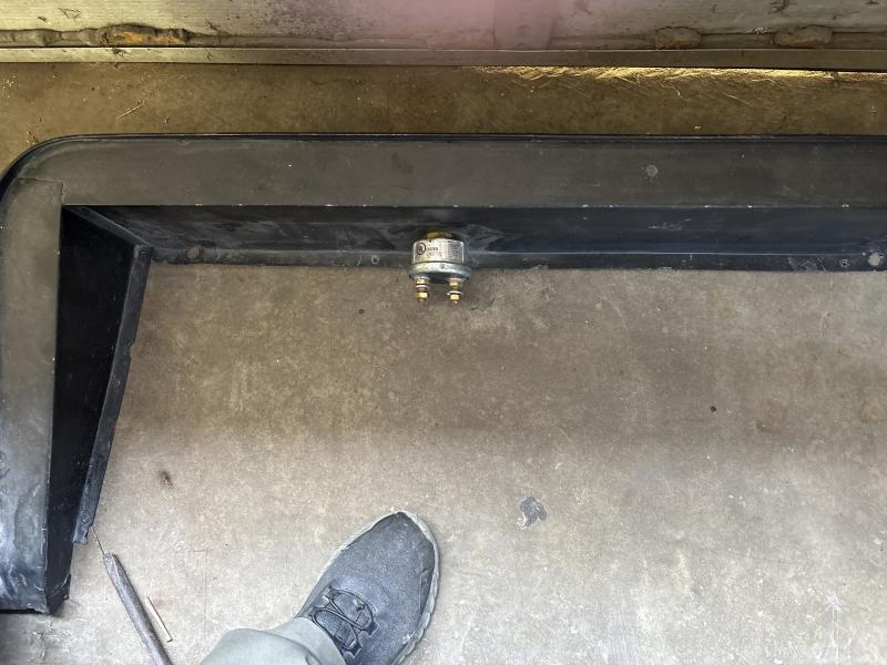

Default Re: Battery Disconnect / Isolator
I have my disconnect switch mount in the floor just in front of the seat in my Town Sedan on the ground wire.
From Bottom:

Posts: 690
Y-Blockhead did you just mount it in a hole in the frame or did you have to drill one.
Do yu have a picture of it mounted.
Tom, I had to punch a hole in the cross brace in front of the seat. I will try to get a better picture later today.

Tom, here is a different angle. That is the brake crossshaft just below it.

Tom, I don't know if this helps are not, hard place to get a picture...
