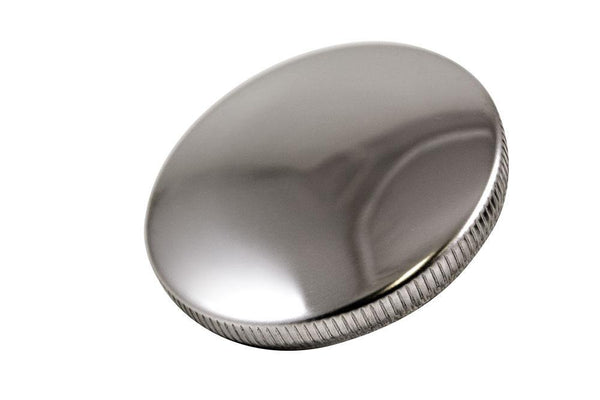

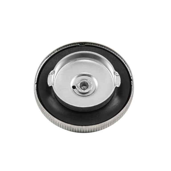

Part # TC-32PV
Description:
1932-48 Ford Chrome Fuel Cap for 2-19/32" Neck- Vented
TC-32 Back Side of Cap - Non Vented
TC-32PV Back side of cap. Pressure vented.
TC Back side of cap. Vacuum relief.

Old 05-18-2026, 06:27 PM   #19
34fordy
34fordy's Avatar
Join Date: Dec 2014
Location: Fort dodge, Iowa
Posts: 1,453
Default Re: gas cap leak
[QUOTE=petehoovie;2451565]See > https://www.tanksinc.com/index.cfm/p...prod/prd91.htm
Only $15.95
Part # TC-32PV
I ordered and received this nice cap today. I put my mouth on the blue (check-valve) and found that I had to lightly suck to open the vent. I am wondering if this negative pressure affects the fuel pump discharge pressure or the pumps ability to bring fuel to the pump. I would think that the pump pressure would not be affected.
