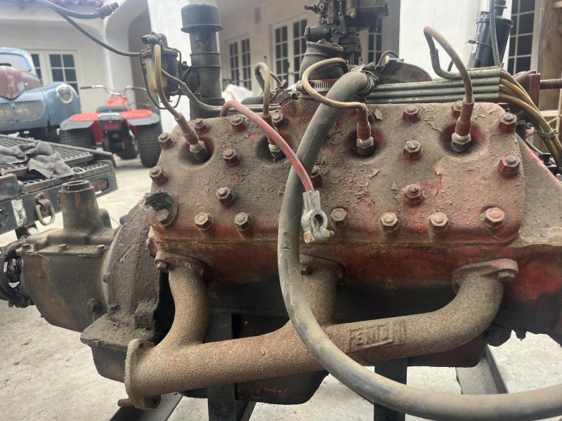

for the 30 hot rod

The Fenton cast iron headers are probably worth $200 or more especially if they are the original ones from the fifties that fit better.

I am not a V8 man so I am going to ask a stupid question. What model V8 is it?

There are a few versions of the flathead and it would be nice to know which one this is.
From the number of studs on the cylinder head this appears to be a "24 stud" motor from 1938 or later.

pre 1948
good score for $200. the headers and the tranny are worth that.
engine is gonna cost north of $7000 to get it hotrod ready. IF the block is good.
flathead v8 is not a poor mans sport anymore, but i guess nothing really is.
should be a fun project.
ps. look closely at the valve seat areas for cracks and then also have it magnifluxed before you start

Originally Posted by old ugly View Post
pre 1948
If that one doesn't work out I have access to a fully rebuilt '34 flathead long block with most all components. Dist, starter, fuel pump water pumps, wiring looms/with new wire. manifolds, rebuilt oil pump, 94 carb, and maybe a few things I forgot. $3450.

A lot of mods go into a model A frame to use it for an AV8. The motor looks to be a post war 59 series but a person needs to see the big "59" on the rear clutch/flywheel area or half bell if you will, but that's not a guarantee of it being a 239 engine. Ford made 221 blocks that had the big 59. The frontal characteristics will tell as in the pencil test.
The 59 block is a good one for AV8 conversions since it's already set up to be the shortest possible from front to rear. Model As don't have a lot of room down front.
Many a person has purchased a flathead V8 engine only to find it cracked in the valve pockets from overheating or cracked due to freeze up of the coolant in the water jackets. It's a fair amount of work to tear one down unless you have the usual trouble saving tools for valve removal. Brake a leg on that one and hope for the best.
