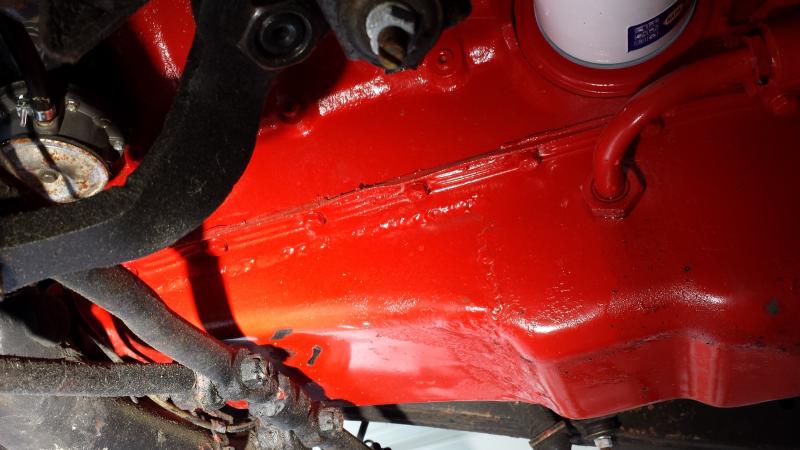

From what I have read Tbird pans are non existent but the pickup pans if modified will work. Mine had to be modified to miss the steering. I wanted to post a photo of the pan but don't see a way to do it. Found it.

Modified is a much nicer way of saying it. The bird pans are out there, just a bit pricey. If yours works, no problem.
