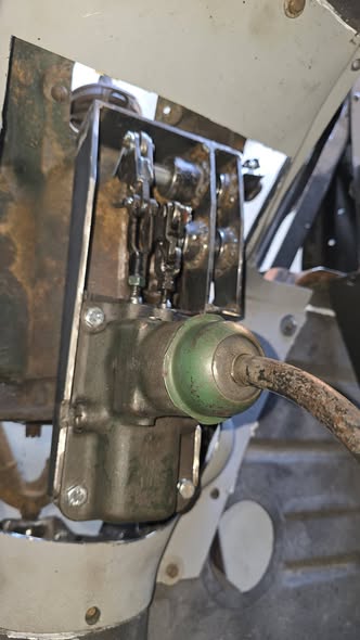

Brian said I should post this. So here's a shifter conversion that one of my clients has done here in Australia. He's been rebuilding a Pilot by himself , body mechanics, all. Doing a great job I might add, I just give him advice on the mechanical stuff now and then.

Curious . . . what transmission is that? On Hell of a lot of work!

it's a column change trans, converted to floor shift. Pilots were originally column change....one hell of a lot of work, why not just use the Pilot gears in a floor change housing?

Brilliant! I love seeing someone using their skill and initiative, to convert what they have, into what they want.
