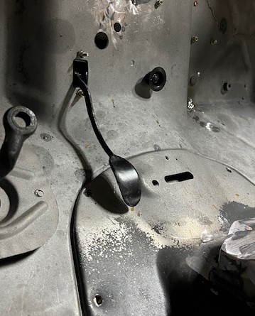

here are pictures;

Maybe just tip the spoon up? How fragile are these things?

Looks like someone had a heavy foot and bent the pedal down. Not sure about a 41 truck but the spoon in my '34 is certainly forged, it has the stamping lines on both sides. I'd heat it and bend the pedal back up. Possibly someone with a good one in a truck could give you a correct floor to pedal measurement. Just for comparison my '34 spoon is 2 3/4" off the floor at its tip.

I have one I know is from a '40 Ford car and it is 10" long. Maybe they used the throttle rod from a car on it. You would think they would be the same length though. I agree with some of the others, I would just heat it with a propane torch and bend it up a little more....

Set the length (by bending) so the pedal is about 1/4" off the floor at WOT. The "give" in the rod and sprung ends will allow the pedal to hit the floor without damaging anything but you know you will have true WOT. Make allowances for matting etc.

The photo of your accelerator spoon looks to be very close to the floor. I'm with Mart on this one...bend the accelerator itself somewhere to get the spoon up off the floor. It will take some effort but it can be bent if you apply leverage in the right place. We do it all the time with our Model A's when the same problem occurs.

I bent the spoon up about 3/8 in. It still wasn't enough to open the carb. all the way and the curve in front of the spoon now hits the toe board at the same time as the spoon hits the floor. If I ever get this thing on the road It'll have 2 holley 94's on a Super Dual. I didn't want to modify this rod when I might be able to use it later. I'll try to find the screw on ends and build one the correct length.
