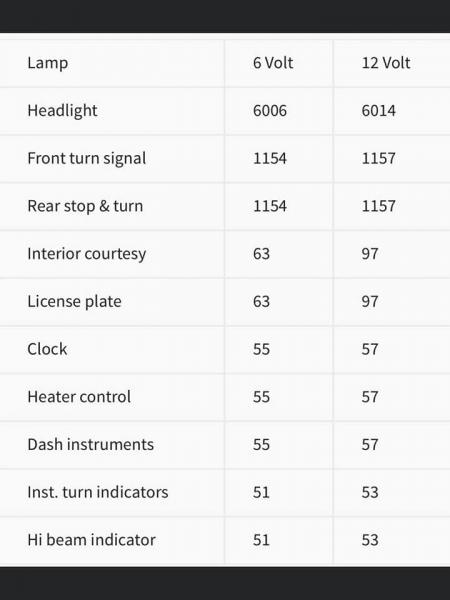

I'm of no help on the '55 gauge panel removal. If it was a '54 I could tell you. Just know, it will come out. Thought I'd post the 6v to 12v bulb conversion chart..........
https://www.fordbarn.com/forum/attac...1&d=1761765931
