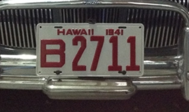

When I did this display plate I painted the whole plate red then masked the letters/numbers and cut around the masking with an exacto knife. I then painted the white, when dry I used the exacto knife to peel off the tape.
