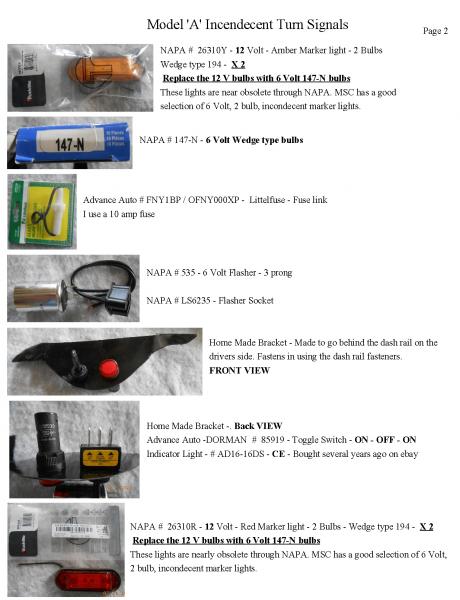

Sorry guys! I am an old timer with old ideas. Installing turn signals on my 1929 Roadster Pickup that I bought in 1955. The local Model A tech specialists complained about NO TURN SIGNALS so I decided to make them happy. Too stubborn to use LED, and fight with 12 volt conversions, so I searched for the same lights that I used on my 1929 Phaeton. Ordered 2 amber and 2 red, 12 volt, incandescent, double bulb, slim style lights (I will switch the bulbs to 6 volt). I will install the same as I did on the Phaeton several years ago. Front lights between the bumper bars, rear mounted to the bed side rails in holes that are already there after making a special bracket.Total package will be about $75.00 Pictures when I get everything to do the job. Picture taken in about 1967.

I used a plastic toggle switch from Auto-Zone on the phaeton. Worked great.
Bought one yesterday from Advance ($6.00) on-off-on. Be sure to wire the switch backward so that left is left and right is right. It is not a lighted switch because they all seem to be 12 volt. I did put in a bright indicator light and a 10 amp fuse link. I ran all wiring behind the gas tank and all the electrical stuff is behind the drivers kick panel. When the lights arrive I will lay out all of the pieces and get a picture. Today I made the panel for the toggle and the indicator light. Tomorrow brackets for the rear lights. Wiring will be the worst part, feeding and fastening everything underneath!

All the parts are here! Pictures with numbers. Another update when they are installed and working (I hope)!

With my Sportlight handle, and spark advance all on that side, it didn't leave much room for a turn signal switch. So I opted for a double throw-single pole toggle switch under the dash rail (post #3).

Lights are all mounted. Problem with grounds. I mounted the front lights on the spacer between the bumper bars but I think my ground problem is in the bumper end bolt area, or maybe where the bumper mounts attach to the frame. I HATE electrical work! So, I am trying to track my ground connections from the frame to the lights. Head lights and tail lights work fine so I assume that I am loosing continuity somewhere between the frame and the mounting on the bumper end bolts.
