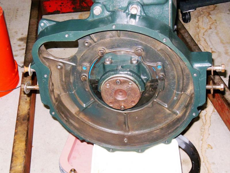

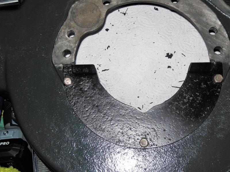

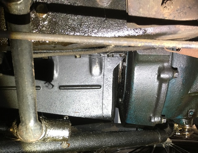

The first thing you should do is to put your general location, the guy around the corner may have one you could look at. I assume you are using a 1932 Model B, not the 1933-34 Model B. I did this with my '31 RDPU. I chose to keep the A transmission as it mounts the brake, clutch and wishbone. I used the Model A flywheel cover. You will need to remove the rear of the B oil pan (see photo). I left a strip of metal on the pan as I didn't want to remove the spot ends and risk a leak. I have been told you cannot remove the rear bearing to adjust the shims but haven't tried it yet. I think I would recommend using a Model A head to get rid of the 3 bolt water pump.

Originally Posted by midgetracer View Post
If you use the B flywheel housing and B style rear float a motor mounts it will bolt in place, but you will need an adapter to mount the A wishbone. So to answer your question, No it will not bolt right up.
Help me out here. I thought the Model A wishbone mounted to the Model A transmission case which I assume he is going to retain. Am I missing something?
Charlie Stephens
When bolting the A trans to a B engine, it includes the A bell housing. That's why you have to cut the back off the B pan.

I have Model B engines in both of my Model A's, and they have the following:
>Model A 6:1 hi-compression cylinder heads so I can use Model A water pumps and get some extra power. Model B water pumps are hard to find, they are extraordinarily expensive and pump shafts are difficult to find. The head gaskets are copper Model A items. The 2 additional coolant holes in the Model B block were left open;
>I use the Float-A-Motor front & rear engine mounts;
>The flywheel housing dust cover is notched to clear the Model B rear main bearing cap;
>On one Model A I modified a Model A oil pan to fit the Model B engine by enlarging the cutout for the rear main bearing cap, and dimpling the sides of the pan to clear the larger Model B connecting rods. On the other car I used a Model B oil pan by cutting-off its Model B flywheel housing;
