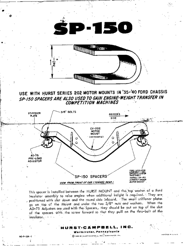

As I understand it the difference is between pre and post 1941. Hurst lists the spacer for use their standard mount series in '35-'40 Fords. (they were initially designed to be used for '41 through '48 vehicles.)
"petehoovie" - Here's another problem with posting pictures. The picture here is a .pdf, and when I click on it, it downloads. Do you know how to make appear inline in the thread?

That's another option if you don't want your engine and engine compartment to appear too be an original '35. The '37 to '48 stock type water pumps will work fine and will actually give you better cooling by pumping the coolant thru the lower block more efficiently than the early style pumps mounted in heads. The motor mount feet on the '37 to '48 style water pumps will sit on the rubber donut motor mounts exactly like the '35 mounts. You do not need those U shaped spacers shown on another post here. They would normally be used when installing an 8ba engine with '49 Mercury water pumps with wide belt pullies. Or truck water pumps could be used with an 8ba engine and again no U shaped spacers would be necessary.
