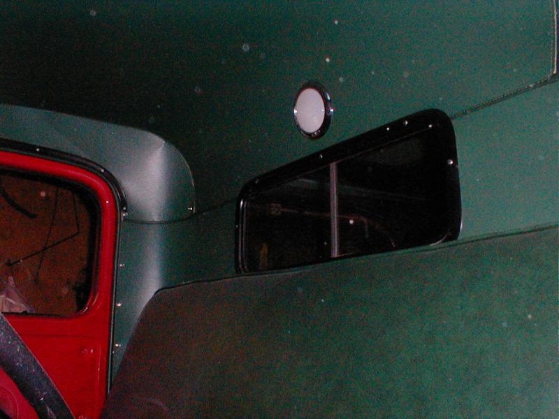

BS Ford did have a sliding rear window in a 41 truck, more prevalent in canada than in us but they were offered. have on in my 41
One thing they didn't have were those stainless screws and cup washers through the carboard panels.
