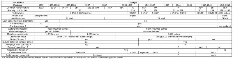

Over a decade ago we did a big thread on 221-239-255 flathead V8 engine identification, link here. Many people contributed knowledge and pictures to that thread, and it was referenced frequently. Since then Photobucket has changed how they do business resulting in the pictures being a mess. The old posts are no longer editable after such a long time, for understandable reasons. This thread is a re-start with new picture posting method relying only on the Ford Barn. The information here is consolidated from both that first thread and many other discussion here on the Ford Barn, with many thanks to everyone who participated in adding information both to that thread and in other threads since then.
This thread is intended to provide the information for identifying the core engine. It is not intended to provide every detail of each year engine. For that level of information please see the applicable Early Ford V8 Club book covering the specific year you are interested in. Rather, for this discussion the focus will be on the engine block as the identifying part of the engine. Anything bolted onto the engine block should not be used to identify the engine. All other parts of the engine can, and in many cases, have been be swapped between years & types. Ford Motor Company was one of the first to swap parts between years, with one example being fuel pumps being swapped onto one year old cars in 1933. Ford had a service program to keep customer vehicles running, and had no care in the world for detailed correctness on how the vehicle was originally built on the assembly line. As an example later in this thread will be a picture of Ford service literate that has obvious mix-up of engine blocks, but worked if all you cared about was keeping your vehicle running well.
There will be a lot of pictures. The 1932 V8 engines are the starting point and changes from there will be pointed out in chronological order for each successive USA type. Each engine type discussed afterwards will detail the changes from the previous type(s) of engine. When viewed in chronological order the details of the engines make more sense as the evolution of design. The following table includes enough detail to identify each engine type produced in the USA. Each engine type identified in the table below will have a post with the information and pictures clarifying the features. You may have to scroll through multiple sections to find a picture of a specific identification feature from the table, one example is the picture showing the “pencil test” is in the 1938 24 stud section.
One last thing about this table: a model year that spans two different features does not indicate that early vehicles in the year used one feature and late vehicles used a different feature. This does indicate Ford produced two design engines with either features side-by-side during the model year (this was a Ford practice apparently to ease into a new design).
For some reason this image insists on uploading in small low resolution format. I also uploaded a pdf, please open that for easier reading.
Most of the information I will post initially is on USA domestic production engines cast in the Rouge plant in Dearborn Michigan. After going through the USA production there will be a bit of information on engines produced outside the USA: at the Windsor plant in Canada, at the Dagenham plant in England, at the plant in Cologne plant in Germany, and at the Strasbourg, then Poissy plant in France. I still have a lot to learn about the production changes from these plants and hope more is shared by the knowledgeable folks here on the Ford Barn.
File Type: jpg 32_53_USA_V8_blocks_2023_12_29_cropped.jpg (44.5 KB, 386 views)

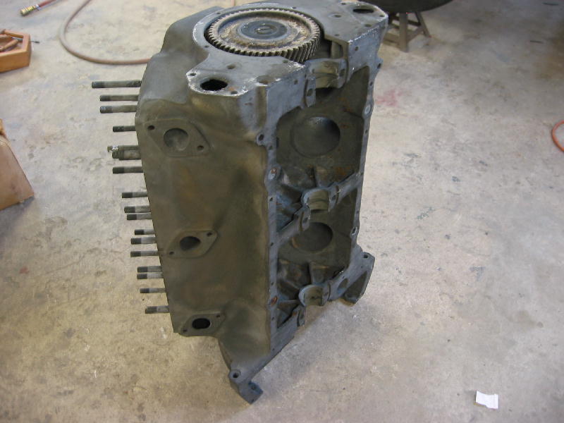

Identification of Ford Flathead V8 engines has to start at the beginning, with 1932 motors. Almost everything in the 1932 engines are at best one year only parts. Most of the parts were revised several time during the 1932 model year production. Henry decided to introduce the V8 before it was really developed so the public became the testing crew. This wasn’t a great idea as there were numerous problems with the early cars, mostly related to the engine. Rather than provide an incomplete version of the story I’ll direct you to other very good sources: The 1932 Ford Book (2 volumes) by David Rehor, articles on the subject by Dave Cole in the V8 Times, and The Early Ford V8 as Henry Built It by Edward P. Francis and George DeAngelis.
Features of the 1932 Ford V8 engine blocks common to all the 221-239-255 Ford flathead V8s are:
  • Flathead design
  • 90 degree motor (90 degree angle between the cylinder banks)
  • The cylinder bores do not line up with the main bearing center-line, which occasionally causes confusion (Desaxe principle)
  • There are eight intake ports, one per cylinder exiting in the top center of the engine
  • There are six exhaust ports exiting on the outside of the engine, with the center cylinders on each bank sharing a port
  • The crankshaft runs in three main bearings
  • The camshaft has three bearing journals located above the crankshaft main bearings
  • Valves are 1.5 inches head diameter
This list of features is more extensive than for the later engines since many of the features continued to multiple years of Ford flathead V8 221-239-255 production:
  • The water drain ports are vertical
  • 21 studs retain each cylinder head
  • Water pumps are in the front of the cylinder heads
  • There is no crankcase ventilation
  • The front face of the block is smooth
  • Approximately 221 cubic inches
    • 3 1/16 inch bore
    • 3 ¾ inch stroke
  • 1932 blocks do not have cam bearing inserts, the cams run directly in the machined cast iron of the block
  • The main bearing caps are retained by main bolts, with the bolt heads accessible inside the valve chamber (main bolts being similar to Model T and Model A design)
  • 1932 camshafts are made from forgings
  • 1932 crankshafts are made from forgings
  • The crankshaft has a very short “snout” sticking out in front of the timing cover, just long enough to install a fan belt drive pulley
  • The crankshaft is 24.47 inches overall length
  • The rod bearings are floating inserts (one insert per throw serving two rods) with a journal diameter 1.998-1.999 inches
  • There is no rear seal surface on the crankshaft, a “slinger” is used for rear main bearing oil control
  • Hard valve seats are installed for both intake and exhaust valves
  • The top of the block between the intake ports and the cylinder banks is machined flat
  • 1932 main bearings are poured Babbitt with a journal diameter 1.998-1.999 inches
  • The exhaust ports are raised compared to the outer wall of the water jacket
  • Oil pressure is controlled by a relief valve in the front of the valve chamber, with the bypass oil aiding in lubricate the timing gears (no pressure relief valve in the oil pump)
  • The bell housing is cast onto the cylinder block
  • The block above the timing gear opening is straight so that a pencil will rest there
  • There are core plugs in the oil pan rail (used to remove casting sand in the water passages from the manufacturing process)
  • The center water hole in each deck is an upside down keystone shape
  • The bottom center water hole in each deck is an upside down keystone shape
From that list, the two features of the 1932 blocks that can quickly be used for identification are:
  • The water drains are straight down
  • The front of the block is flat with no has recessed areas between the water inlets and the timing gear
Here is production V8 engine #1 (prototype engine 243 that was run down the assembly line so Ford could officially start production of V8 cars), as displayed in the Henry Ford Museum.
This picture shows many of the features of a 1932 V8 block. Note the three main bearings, cast in bell housing, core plugs in the oil pan rails, “raised” exhaust ports, straight water drain ports, flat front of the block from water inlet to timing gear opening, and no place to install water pumps.

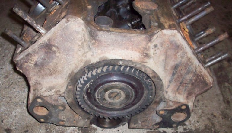

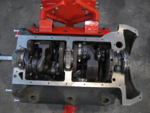

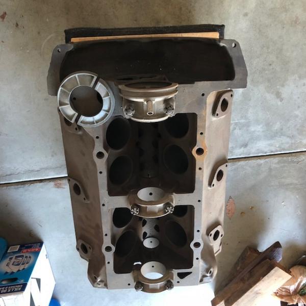

This picture shows the crankcase area and main bearing caps on a 1932 block. Note the lack of any crankcase ventilation. The main bearing bolts can be seen to the left of the block.
Here is a different view of the crankcase area and main bearing caps for a 1932 block. The tube coming off the rear man bearing cap is the oil return from the crankshaft slinger.

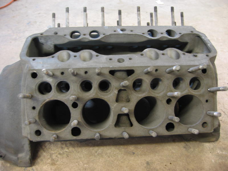

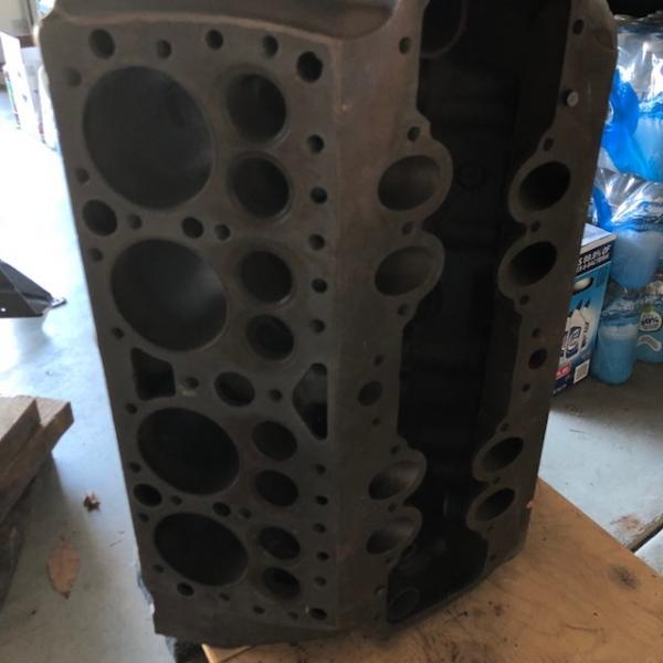

This picture shows the cylinder deck and intake surface of a 1932 block, which looks similar to the other 221-239-255 blocks. Note the 21 studs, easily differentiated from later blocks since there is a stud directly below each cylinder. Also note the upside down keystone water passages in the center and bottom of the middle of the deck.

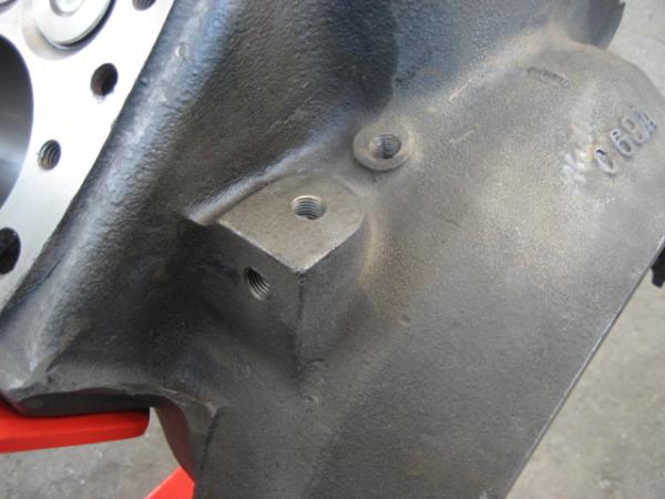

This picture shows the valley of a 1932 block. Note the holes for main bearing bolts, the fuel pump push rod boss on the left, the oil galley tube down the middle from left to right, and the hex plug on the right covering the oil pressure relief valve. Also note there are no passages for crankcase ventilation.

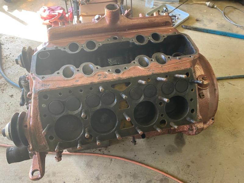

Here is an assembled 1933 engine with aluminum cylinder heads, stamped steel pan, etc.

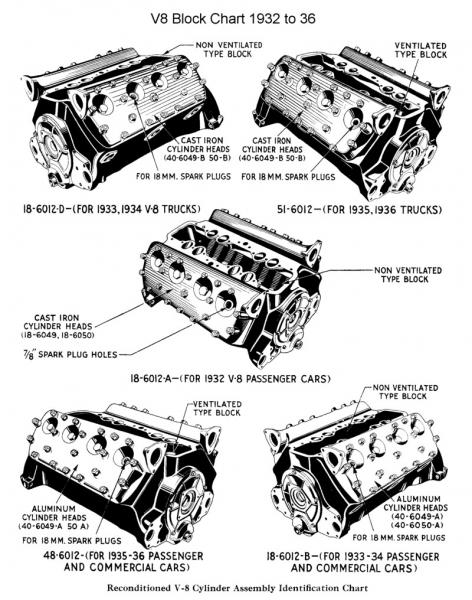

This is as good a time as any in this effort to show both how little Ford cared about retaining production line “correctness” and how easy it is to mix-and-match parts between years. This picture is from Ford from the mid 1930, for engine identification to be used in the engine exchange program. Keen eyed viewers will notice that:
  1. The long blocks for both the 1933-1934 V8 Trucks and the 1933-34 Passenger & Commercial Cars are actually 1932 production blocks with the flat front face.
  2. The long block for 1932 V8 Passenger Cars is actually a 1933-34 block with the recesses between the timing gear area and the water inlets.

Here is a picture of a 1938 24 stud motor. The cylinder heads are one year only, featuring a cast in part number on the face of the heads. The battery cable is not supposed to attach to the middle head stud.
Here is a picture of the “pencil test” being performed on a 1938 24 stud. The pencil is resting on the front of the block just behind the timing cover. If you can do that your engine passes the “pencil test”; make sure you are not resting the pencil on the timing cover itself. You can also see the short crankshaft common to small insert main bearing crankshafts and blocks.
