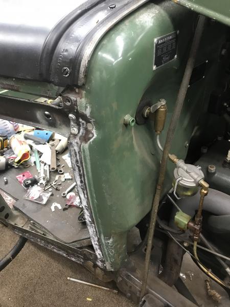

Here’s a picture of the cowl and frame area , your car should be the same , the firewalls on 1930 and early 31 are the same , later 31 have an indented firewall around the gas shutoff area, but fitment would be the same. Engine mount would be where the 3 bolts are on frame.Also if I remember correctly a 32 side frame rails are actually the splash apron and frame would be longer than a Model A.

Picture of opposite if it helps.

Firewall, outer cowl off

Hello again another poor quality picture of the bracket for front body mount, with wood block between body and it , firewall to frame has around 1/4 gap . Are you trying to mount fire wall directly to frame? Should be a couple of shims that would move the firewall up to cowl .Trying to figure what a previous owner did can be frustrating.

In your last picture we can see where you are off.You used logic,in thinking because the holes in the subframe,block,and the mounting flange all line up that is how they go.Not the case.Only one bolt is used on the 2 bolt frame mount,not 2.One hole is empty.However,the one bolt at the foot of the firewall should drop through the single in the frame itself.Slide that cowl ahead until only one hole in that flange lines up,then see where everything else lands.
