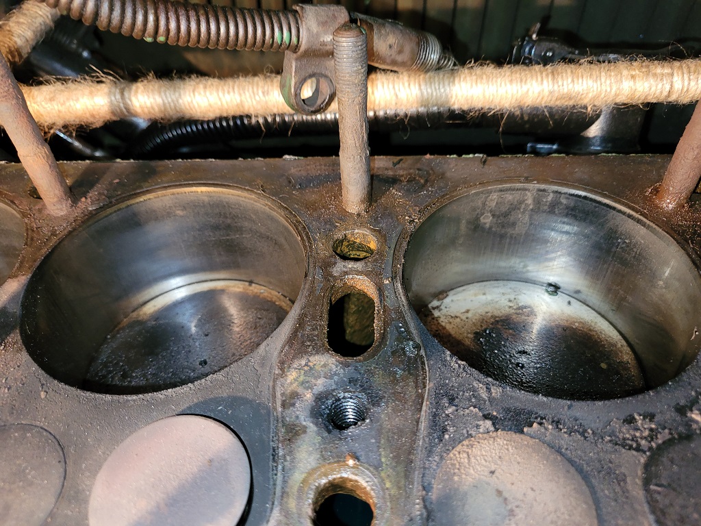

Hi folks...
yesterday I took off my cylinder head because the head gasket was burned... Of course I broke off the base of the ignition distributor...
Ordered some new parts today and looked at the engine again and found that the cylinder walls are almost mirror clean!!!
The engine ran well. A pressure loss test beforehand also showed a loss of only 25% on all cylinders. (In the middle of the green area of the display.) However, I don't really like the bare cylinder wall. Can anyone tell how I should deal with this problem? I'd like to hone over it, but I don't want to pull the pistons. I have concerns with the connecting rod bearings made of white metal.
What would you do?
Does anyone have the material composition of the liners?
MFG Andy

The cylinders look great with the exception of a little bit of corrosion on #2. Cast iron has a unique property in that it takes on a mirror shine after being broken in. The graphite and iron produce the shine. You only need to hone the cylinders if you are going to put new rings in and only because it helps the rings to seat.
Run the pistons up near the top of the cylinder and then try to move the pistons front to back and side to side. There should be no perceptible movement or only a very tiny amount. If you get a large movement then the cylinders and/or pistons are worn.
Put some light oil like 3-in-one or sewing machine oil on top of the pistons and watch to see if it leaks down past the rings. You only need a small amount. It is leaks down within an hour or two then you may need new rings, and if new rings then you need to hone the cylinders. In the old days it was typical to replace the rings and lap the valves frequently and maybe take up the bearings at the same time. It was sort of a maintenance thing. If the engine was making blue smoke and had a lot of blowby then that would also indicate new rings are needed.

Nothing wrong with the cylinder walls. They wear in and are shiney. Do not know what you mean by 25% loss of cylinder pressure, what is the actual reading? But, if you want to replace the rings while you are at it, just hone the walls unless you have a substantial ridge at the top. Then get a ridge reamer. Used to be able to rent them at rental shops. You can get a stone hone at Napa for home use which is fine for stock use. No need to get a machinist to do it for a basic ring job. As noted, used to be just normal maintainance. Do not worry about the babbitt. The carbon on the pistons is not excessive so I would say your rings and valves are fine. Sounds to me like you have basically good engine,.

Model A pistons have wide rings that tend to shine the cylinder wall. And don’t seal as well as modern thin ring pistons.. that being said, it also reduces cylinder wear, which is a good thing. Your combustion chambers should be darker, your running a little lean, check manifold for vacuum leak.

The cylinder walls look normal. Use them as is.

Liners are propriety alloys of ductile iron. As mentioned above, cast iron has the property of taking on a smooth shiny surface. Once that surface is obtained the wear rate goes way down. Race cars will use aluminum blocks with a hard coating, like silicone carbide, for the pistons to run on, but they are throw away engines and not expected to last long. Jaguar tried that for their production cars in the early part of this century and most of those cars are now scrap. They went to putting cast iron liners (sleeves) in their engines. Lesson learned.
It is precisely because of THESE statements that I am asking here. One is too fixated on modern materials. If the cylinder wall on a modern engine looked like this, everyone would say it's gone. The oil film would tear as soon as the engine was started and the pistons would seize up. Anyone who, like me, does not know the properties of the material pairing of iron and graphite will inevitably draw the wrong conclusions. So a big thank you for the explanation. I'm going to leave everything as is and only clean, dry and oil a little when assembling.
There really isn't any corrosion. That should be an optical illusion.
As for the pressure drop test (25%)... I did that a while ago. I used this tester for that. The pointer stopped at 25%, in the clearly green area. This confirms that the piston rings and valves are properly tight. No reason to make any repairs.
But that's only been the case for the last 180km. Before everything was clearly black and full of carbon. That's a flaw I'm looking for in my carburetor. I had a replacement carburetor from my uncle for the last 180km, where the engine only uses half the petrol. 9 instead of 18L/100km. With these carburetors, everything has actually burned itself free. I will probably have to overhaul my carburetor.
What I am unclear of is if the head gasket was burned, I would assume you had either a combustion leak -or a water leak? If it was a combustion leak, is that the area I am seeing between #3 and #4 cylinder? If so, why were all the leakage readings the same? Why were the cylinder leakage numbers of the affected cylinders not different??
I also asked myself this question, especially since the pressure loss test was only carried out when the development of the noise indicated a defect! But the answer is quite simple. The pressure loss test is only tested with 2 bar. The head gasket was still sealed at first. The pressures during compression / combustion are many times higher, even with low compression. That's why the error wasn't noticed there. If I had done a compression test, I would have noticed the defective seal sooner. But I didn't have that gauge back then.

Andy, it appears your mind is already made up, ...which I am OK with whatever your decision is, -however for the benefit of all the other readers who will come along at a later date and likely obtain misinformation from reading this, I will post some thoughts;
To begin with, it appears you are using one of those cheap Chinese-manufactured gauges which have been proven to give erroneous readings. They are cheap for a reason. Most professional engine rebuilders (-or mechanics) would never use use that poor quality level of a tester. Mine is a OTC brand with calibrated gauges that are certified. It does not have colors on the gauges as that feature is useless. It uses a scale of 0 - 100 only. The Green, Yellow, & Red colors on your gauge mean nothing as it is all about percentages which those numbers are different between types of engines and the usage of that engine.
Next, by you telling me you used 2 bars of air pressure to test with, therein lies the issue with your test. Your gauge is designed to be operated with EXACTLY 100 psi (-approx 6.9 bars) of line pressure. For proper (-i.e.: accurate) leakage readings, this psi number is crucial as that 100 psi number is the benchmark for determining 100% -or any percentage of that. Had you used the tester properly and introduced 100 psi into the cylinder, your percentage of leakage findings would have likely risen exponentially.
