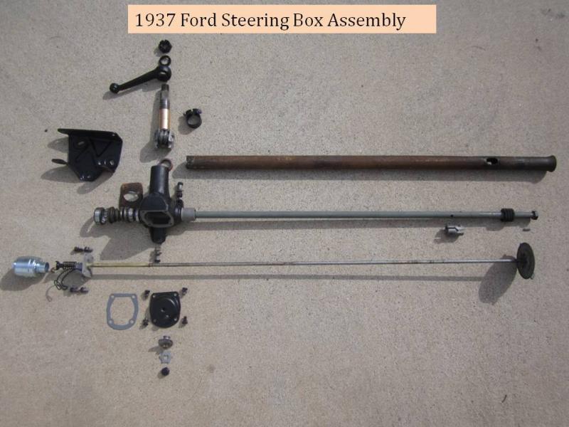

I recently bought a complete used 37 column, box etc. I’m wondering if someone can post pictures of the screws/bolts that hold it together? Mine appear to be all broken. But I’d like to confirm before I drill and try to remove them so I can get it off the column and apart. Thank you, Chris.

I have some detailed pictures of the column drop and the bolts that hold it to the dash. Would this help? I also have some pics showing an exploded view of the steering gear box, along with the mounting plate and bolts that fasten it to the frame.

OK, I am bored so thought I would attach some pics of the steering box assembly, etc.

wow thank you so much! the twist off screw is sheared and that was what was throwing me off how to remove it. Any idea where i can get a replacement? ill drill and extract my old one. thank you so much for so much detail!

I had the same problem on my37 Fordor. I carefully drilled it out and installed a set screw in its place.

1937sedandelivery...That is friggen' gorgeous....way above & beyond. NICELY done! DD

Gregg, Excellent!! Excellent job on your '37 steering column picture posting! With your permission, I would like to download all the information you have posted here to my files for future personal reference, and possibly to repost when someone else is seeking info, or has questions on the '37 steering column assembly.

You don’t need to drill the pinch bolt completely out. I drill a line of 1/16 in holes across the face and use a screwdriver to screw them out. I reuse the bolts.

I do the same thing, but occasionally I can't get that bolt to break loose using a handheld screwdriver, so I go to a handheld impact driver to get it to start turning, then use a regular flat blade screwdriver to bring that bolt completely out. Some penitrating oil on the treads can also be helpful.
