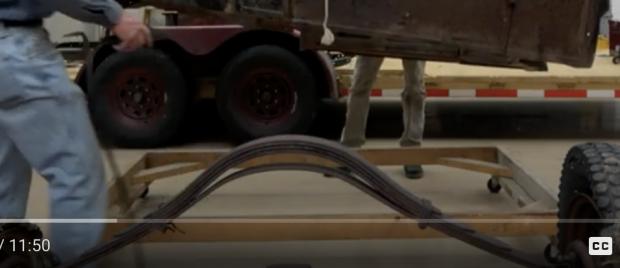

I was watching the Victoria Restoration on You Tube and I noticed the rear end sitting there. Only thing holding the spring together is the spring clamps. Center bolt is gone. Yikes
