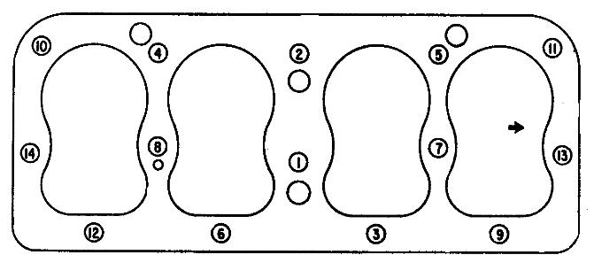

Posts: 647
Default Re: Leaking head gasket
Great idea on sequence.
I Love Anything That Turns Money Into Noise

File Type: jpg Model-A-Engine-Head-Torquing-Procedure.jpg (12.9 KB, 29 views)
