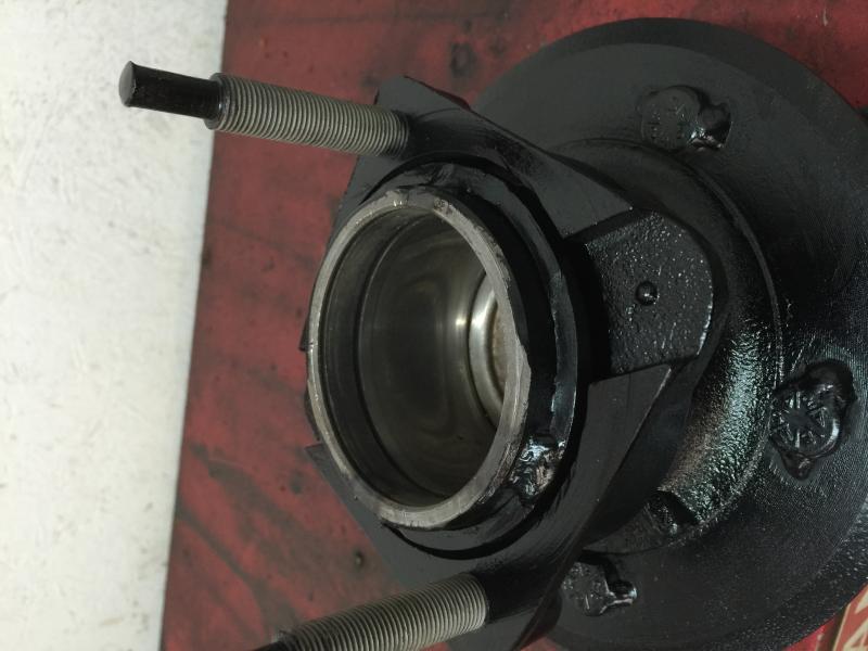

You can buy the old style safety hubs like Ken has here:
http://www.reds-vintage-parts.com/ou...-new-old-stock
and
Or, if you have some 1/8 inch steel, a vise, a saw a drill and a welder you can make your own. If you decide to make your own notice how the top (1/4 in. thick) surface has a curved contour for clearance on a 15 in. rim. 16 in. wouldn't need the contour. Use thin plywood to make your protypes.

Those retainers only work on car drums. I have pickup brakes and drums on my diff, and the drums don't have the right shape lip.

Bassman; Just curious to know what your drums look like. Are they like the 1939 Lincoln drums? Can you post a photo of your drum's configuration?

They're very similar to the car ones, but the vertical lip that the retainer sits over is not vertical, it's on enough of an angle on the outside edge that the retainer will neither fit nor have any grip if the axle breaks.

Wonder if you could make a set of retainers that compensated for that non-vertical mounting surface?
