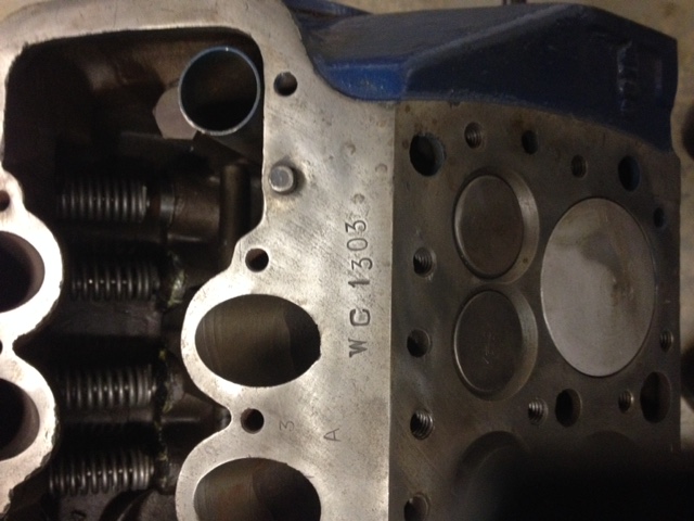

While the 51 Merc Flathead is being checked at the machine shop I went ahead and traded a SBC for this 24 stud flathead. The heads are marked C7RA-A there is no marking at the rear of engine. It does have the rear bell drilled for return oil passage but the cross port is not plugged. I did see a drawing on here somewhere showing the oiling system with an external bypass valve. It is fresh out of the machine shop but is missing the starter, crank pulley and distributor. I have a set of Navarro heads and 3x2 intake that will fit this block. I figure if I can get one or both these engines going I can pick which one suits me best. LOL.

That is indeed a Canadian block. The number cast in front of #1 cylinder will give a positive ID of what year.

Looks like C91 which would make it 39 ford 221ci block. If it is c99 it is 239 merc and its Canadian like Brian says

Thanks guys, the number in front of 1 cylinder looks to be 81. The bore looks to be 3.06 so I think it's a 221 maybe a 38 model?

Yes, it looks to me to be an 81A- 1938 engine, going by the cast #, however, the unusual thing about it is the big, square protrusion off back of Bellhousing where the oil pressure ports are; the big square design is normally post war, the pre war engines normally had considerably smaller protrusion in this area. Just shows...when it comes to things Ford, there is no hard and fast rule!

I've got a C99A block with that large port on it. It had oil pressure switches in both those ports when I got it.

Are you able to post a photo of the casting area immediately forward of #: 1 cylinder? This will help in the identification. I suspect that what you may have is a Canadian WWII 99A i.e. '39 Mercury Block, somewhat like the attached photo of a NOS block that I have.

Here are some more pictures.

The 2nd picture shows the crank snout looks to have a two piece seal in cover and shaft measured 1.314. The third picture shows the dimples in pan rail. The fifth picture is looking down the vent tube, I am guessing the hex plug retains the oil relief? on another note the dipstick mount shows two threaded holes one for the tube not sure what the other one is for but looks like 1/8" NPT ? Looks like a add on piece since it is bolted to the pan and aluminum.

It's a '38 (i.e.81) motor.
The second hole in the dip stick boss is for the oil return from the standard oil filter canister

'Does a Canadian 1938 81 221 have 2.399 " main'
No, the 81 blox run the long snout, big main journal cranks.
The 24 stud, 221 blocks that run the short snout, late 36-37 style crank with the flanged rod bearings, do not have 81 cast on them anywhere.
C7RA heads are late '40's offerings from Canada, standard equipment on C69A blocks. Available in cast iron and aluminum versions

Lord I am getting in deep with these Flatheads. G32, I have no idea what was performed at the machine shop but I will find out tomorrow morning. I have to go and look at the 51 Merc block cracks all around cam shaft area. Rest of the block was good where the cracks usually appear. Hopefully I can salvage enough of the other parts so it's not a total loss. I'll get some pics of the cracked area.
36coupe, from the information I gathered it seems it is a earlier block with later heads on it.
Brian, Thanks for the clarification, I guess it would then have floating rod bearings then? Would it take the long double wide belt crank pulley then? I guess a better question is if it is even desirable for a AV8 build?

Yes, it will have floaters. Yes, it will take the long, double sheave pulley, and in fact, even the 8BA crank will physically fit in the 81A block. But some things would need to be changed in that swap [timing gears, rear seal arrangement] and the 8BA rods won't go down the 3 1/16" bores, so we don't need to get too carried away [yet!!] One of the great things about these old Fords is the interchangability of various componentry.

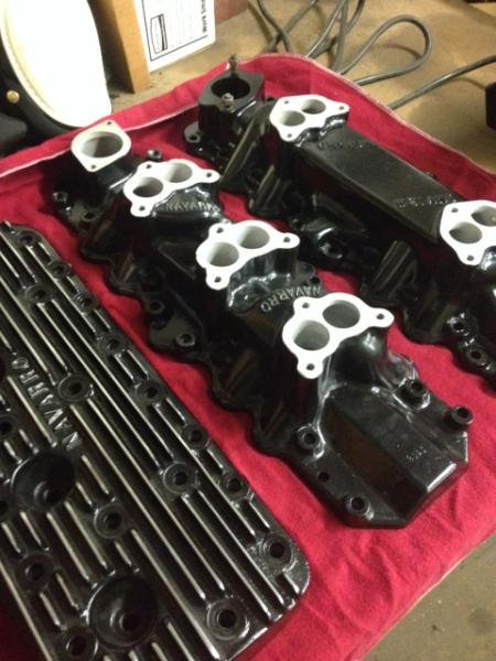

Well the 51 Merc block is trash. Cracks everywhere on the underside including pan rail. I did talk to the gentleman at the machine shop who put the 221 together for my buddy and all he did was freshen up the block,honed, bearings, rings, valves etc. on the 221 flatty. The cam is stamped on the face 5-T and 3370. The only reference I could find is it may be a Clay Smith cam. I have two possible intakes for it with one being a 2x2 Weiand that has the heat cross over but no markings or numbers stamped in it. The other is a Navarro 3x2 stamped 2091 no gen mount, no heat cross over with a set of Navarro heads that are marked 8.75. Did not really find out anything on those numbers either.

Can you post pictures of your block in this thread?: http://www.fordbarn.com/forum/showth...5301&showall=1
I started that thread to identify the US production line blocks. Others folks have kept the information coming including post war replacement blocks and Canadian blocks.
I think you have a 39-40 motor. I would be very surprised if Canada introduced the larger bearings and longer crank before US production did. These changes were made when the Mercury was introduced.

Sure 38 coupe I will post some pictures over there. I may also post the heads and intakes over at the Jalopy Journal and see what kind of info I can get there. Thanks Gary
