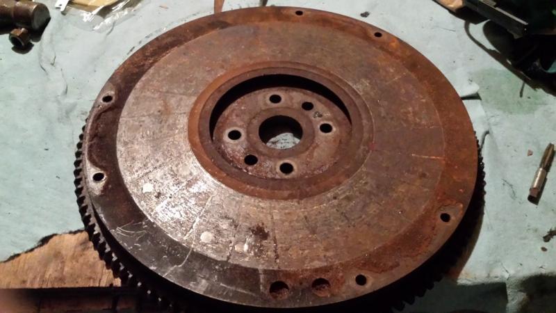

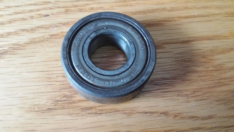

Default Re: Flathead project
I have a question. If I use the original flywheel and mate up a T-5 trans will I need to use a ball bearing in the center bore like the one I removed?
Attachment 208681
Attachment 208682
I am using a pilot bushing in my T-5 installation but there are those who use a bearing like yours. I feel sure we will get comments either for or against.
Attachment 208681
Attachment 208682
YES, Speedway has the right piolet bearing, fits the Ford flywheel and the T-5 shaft. Walt
