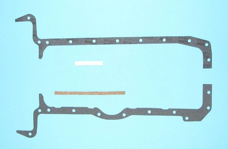

Possibly the cork gasket at the rear main cap that helps seal the oil pan gone bad.Pull the oil pan and replace the gaskets.
