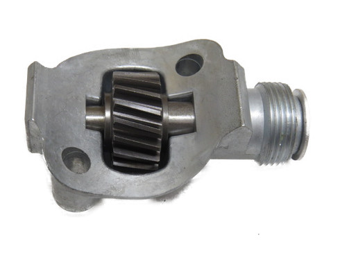

received the speedometer mount today and as predicted by "Duke" there are no numbers on the casting and i'm more than a little upset in that the one pictured in the ad clearly shows the "18" on it.
they'll be hearing from me!
You were cautioned that it was not original. It is in fact advertised with the word "NEW" all in caps in four places. Proof of the pudding is how long it will last. Ask Mike if he can warranty it, given the hefty price it commands. Keep in mind that Mike is not the enemy, he's trying to make do with what's available.

One thing missing that I thought I'd add is how smooth does the cable core and speedometer shaft turn? If they both turn easy with no binding then disregard. I think the driver gears were 13-tooth but it's hard to tell with helical gears. Everything has to be in good shape to insure reliable function. I'm sure the OP is familiar with the speedometer gear chart in the green bible parts book. That's the way to go for proper speedo gearing with rear axle and tire sizes. Just my 2 cents.

okay, here's the final story on my new speedometer mount...
short answer...i'm not using it!
why? because when i went to count the number of teeth, the rotor hung up about half way around. and after i forced it around using my thumb it was still not rotating freely. there was a bit of red (locktite?) and rust(!) on the shaft. even after "working it" for five minutes, it was still not moving freely. so i decided to take another look at the original OEM mount that i had removed the other day and that had questionable threads (see previous post). and decided to use it instead. all in all it was the better option.
BTW, the mount pictured in the ad on the website where i purchased the new mount was NOT the one that was delivered. to me, that's tantamount to buying an original vintage car pictured in an ad, and being delivered a replicar. their website will now serve as the very last resort for parts.
