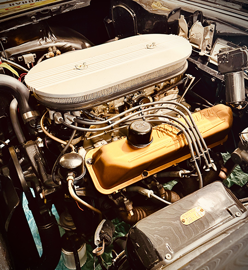

my 63

It is beautiful.
Cause it no harm and/or abuse and cherish it.
Takes me back to better days ...

Now to find someone who has the skills to correctly machine the main body of a carb. Any thoughts?
BTW the power valve was fine although a blown power valve would have caused nearly identical symptoms.
