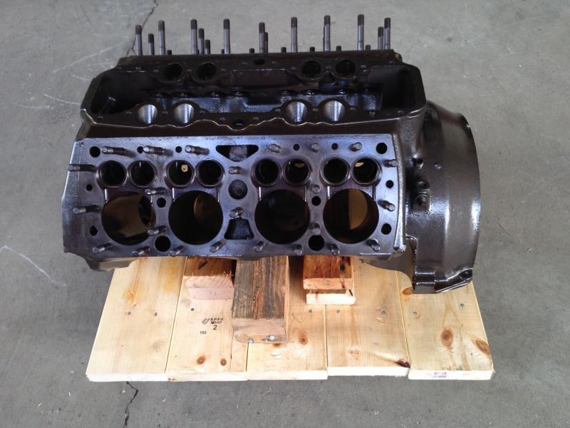

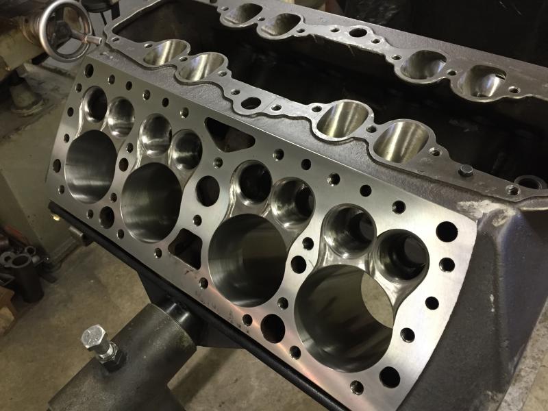

Here are some pictures of my NOS 41/42 Mercury / WWII block. Notice that it has a factory relief, has a raised intake surface and has the round center water hole. It does NOT have core plugs in the pan rail and comes stock with a 3 3/16 bore (239 cubic inches).
The Ford blocks will have a trapezoid center water hole and will be 3 1/16 bore.
I'll include pictures of the AFTER state of the block - as I've heavily modified it for performance. You'll see heavy porting, full relief, large valves, large ports, etc..
Stock:
Heavily Modified:

Beautiful B&S!

Thank you sir! Am going to be building my first flathead again - first built it when I was 15.
It came out of the Kenz & Leslie streamliner that set the records as Bonneville in the early 50's. It is a 59L block - heavily ported, full-relief - just put in 1.75" intake seats and steel main caps from the front and center mains. Had it bored to 3.347 (85 mm) - this gives me a whole host of metric ring combinations to use. I'll have Ross make some custom pistons.
Going to create either an injected or blown flatty . . . just for fun! LOL

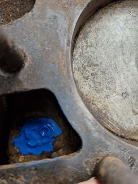

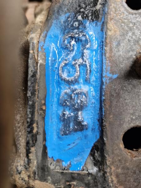

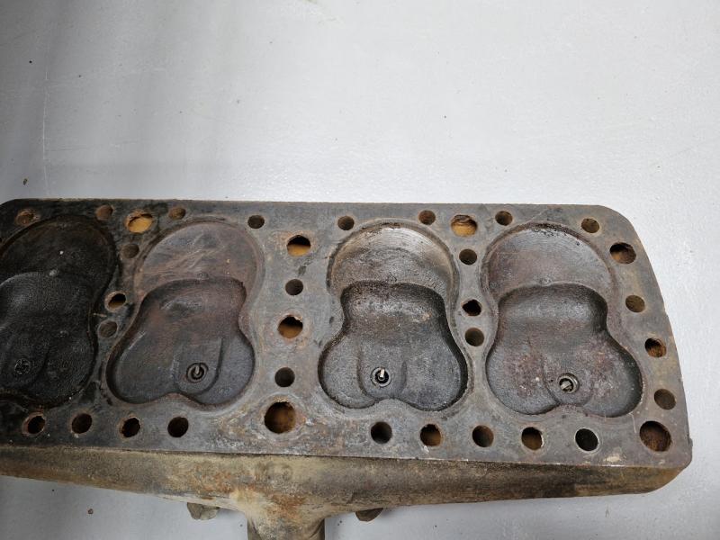

Hi,
what a fantastic thread and resource. I am pretty ignorant about flat head V8s and have been trying to work out what I have in my recently acquired car.
It differs in detail from some of the information here, but I think it is Canadian made Mercury with full flow oil filter drillings. It also has a 59 cast inside the water jacket. The bore is 3 3/16" +.020. It has recessed heads and domed pistons. Photos attached.

I'd say you have a Canadian 59AB engine . . . a "C59A" type of engine.
The water holes on the deck mimic the 39 - 42 Merc or WWII industrial block. My guess is that the valve angles are the same as a USA 59 series block - which are different than the earlier Merc blocks.
I've not personally built one, but it should be a great starting point (if you have the block checked out!).
