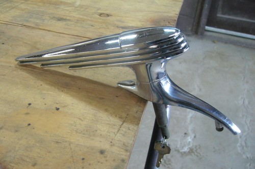

Like this one?

OR a few others, this was one In particular I was thinking. sorry for the poor picture quality

It’s a locking one as you surmised. The top has already been plated and is beautiful. Here are pictures of the troublesome piece. Petehoovie has a picture of the entire piece.

Here's some info. that will help. The plater will want to weld it to assure it is a good solid platable weld. Here's a good example.
https://www.jalopyjournal.com/forum/....992382/page-2
https://www.google.com/search?q=what...hrome&ie=UTF-8
Here's a few platers who can fix your hood ornament.
https://www.jalopyjournal.com/forum/...rs&o=relevance
Several years ago I had Chrome Plater Josh in Indiana repair and chrome plate an expensive broken pot metal horn ring. Turned out excellent. Open thread below and scroll down to Chrome Plater Josh thread. Give them a call. You will be pleased with his work.
https://www.jalopyjournal.com/forum/.../#post-3936114
Here's the horn ring he welded and plated.
https://www.fordbarn.com/forum/showt...steering+wheel
