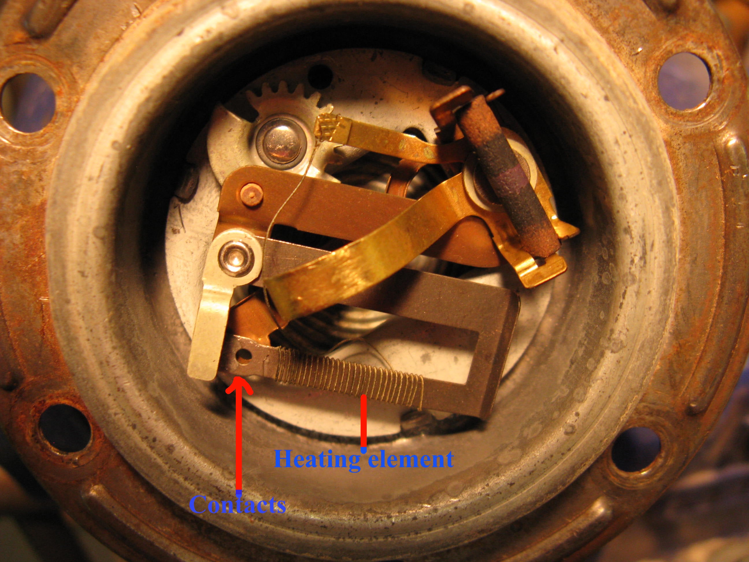

How would I go about testing this fuel gauge for 1936[ATTACH]Fuel Gauge 2.jpg[/ATTACH]

I think you can use a 1-1/2 volt battery to see if the needle moves., if you have an aftermarket sender in the tank you’ll never get an accurate reading on your gauge.

The electric fuel gauge has a coil that heats up with amperage from the tank sender which also has variable output controlled by arm position which heats a bi-metal strip sending amps to the gauge.
From https://forums.aaca.org/topic/238627...-gauge-repair/
"19tom40 Posted June 30, 2014
A good original type sending unit should read near 0 ohms at all positions of the arm. An ohm meter will read the resistance of the coil wound around the bi-metal strip and the resistance of the contact points. The coil only has a few windings and will have very little resistance. The dash unit has no control over the amount that the needle moves, this is done by the sending unit. As the amount of fuel shown by the dash gauge is just an approximate value, the full current test is accurate in determining if the gauge is functional.
Here is a photo of the inside of an original type fuel sending unit. The gap in the contact points is controlled by the position of the float arm. If you do not have an original type available to you, remove the tank unit and connect it to the gauge with a jumper wire. Measure the depth of the tank and bend the arm on the sending unit to travel that distance. I like to have about 1.5" straight section near the part that moves the resister slider and then a 90 degree bend that is adjusted for the depth of the tank. Check to see that it reads full near the top and empty near the bottom. I don't have a photo of one at this time.

If it was me, I'd put a AA battery temporarily across the two gauge posts. If the needle moves, it is good.

I have used a 6v lamp battery to test them. But, be careful not to keep the circuit on too long or the heating element will burn out. When in the car, the heatinng element is not on constantly, but continually is going on and off. terry

If you get the system working but your dash gauge is working but inaccurate, there is a way to adjust the dash gauge to accurately show the tanks contents. It involves adding measured amounts of gas to the tank. Then dropping the dash gauge itself down "live" to access its interior and adjust it's settings. I've done all my dash gauges in that manner. I may have posted the instructions here long ago or you can PM me.

What glennpm said in post #4. I have worked on these gauges for yrs and use a 9V smoke detector batt with alligator clips attached to wires .That hold them secure to the batt terminals.I just touch those wire momentarily to the gauge lugs.If needle moves the gauge is good - to me.I reverse polarity if no movement .If still no movement I open up the gauge and do surgery.Most times that heating element wire is severed.Sometimes I am able to do a repair and sometimes not.
