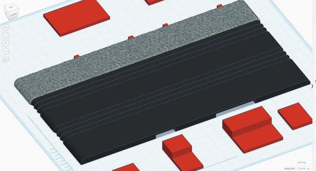

Here's how it looks in tinkercad, the first part done on top. The two other flat areas still need it done.
I actually have to use a combination of four programs to get this... Fushion360 to get the star texture from a height map I made in Photoshop, then into Blender (see below) to get the star texture to 'curve' onto the side panel, and then into MeshLab to reduce the insane amount of vertices so I can then bring it into Tinkercad to add to the main model.
So it's a process! The good news is that once I finish this side, the other long side (with the Ford logo) can use the same panel, just slightly tweaked. So I'm just waiting till I have some more time to sit down and finish the last two sections of star texture, then I can send the side walls to print... and all the 3d printing will be DONE! Then it's just some slight sanding, gluing the side walls together, painting the side walls and the bottom tray with flat black, and painting the Ford logo gold. Then it's finished!

Thank you! Yes, I love Tinkercad. It can't do really complex things, which in the case of the star texture is complex... so I have to use other programs for that. But the basis of the entire model has been built in tinkercad. Takes some getting used to, but you can create an awful lot in little time with it!

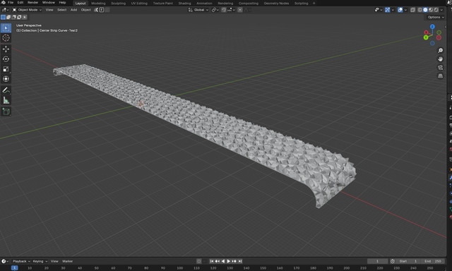

This project has slowed to a crawl as I figure out the best ways to handle the long walls. I've had to forgo tinkercad as these walls are much wider and have a lot more texture to them along with the curved sides. As mentioned in the last update, I finally figured out how to curve the Star texture. Not an easy task. Took me a few weeks to figure that out.
Once I felt I had that down, I rebuilt the entire long side wall to make sure the star texture is the same on all three sections. The mistake I made was the remesh the star texture when joining it on to the basic sidewall that I had created in tinkercad. This created star texture sections with an insane amount of 3d geometry... How big you might ask? Well just this one side wall clocks in at about 3.9 gigabytes and file size! That's insane.
So now I'm trying to work on reducing the amount of detail in order to bring that way down. But the problem is, there's so much detail now it's overloading blender, the 3D program I'm using, and making it crash. So I may have to start back over with the star textures. Ugh. I'm very ready for this project to be finished! It's been over a month that I've been working on just this sidewall.
Good news is when I lined it up with the shorter sidewalks I'd already created and printed, they match up perfectly.
Hopefully I can get this model reduced in size so I can start printing it!

I've actually used just about every 3D CAD software out there with this project... Tinkercad, Blender, AutoCad Fusion360, MeshLab, InstantMesh, 3D Builder, FreeCAD, 3DCoat... None of them could curve the star texture except for Blender WITH the third-party plug-in. Back in the day, I used to build and animate 3D models in Lightwave when I was interested in becoming a CG animator for movies, and I dabbled in Maya. But that knowledge is long since forgotten.
