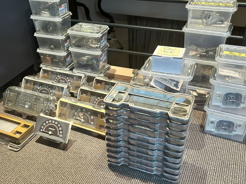

Thank you 19Fordy,
I use Coreldraw (a 30 USD/month software) to trace the latest detail. I think I am a little autistic
Anyway, the biggest challenge is not the tracing. That is just a matter of time and attention to detail. The biggest challenge is the printing and the quality of the decal material. The colors are never what you want, not only because of the printer but also because of the decal material. Also, what is the right color. Who knows? Yes, one can use the NOS stuff that is still around but there also colors can have faded. It takes literally dozens of trials to get it somewhat right. And if you get it right the decal has to be fixed with clear coat varnish. Too much is not good, to little is not good and so on..
It is that undefined upfront that I do not dare to sell the decals, not wanting to buyer to not be satisfied.
(EDIT: The following is for FordyFord which I mixed up with 19Fordy. Sorry)
This being said, your information has also been valuable to me. I did start these restorations, not really knowing what for I was restoring. Thanks to you I know.
I did about 40 clusters with the gauges up to now, not only for Ford trucks and Ford GP's but also for CMP's and armored cars.
This picture is what I see sitting next to me here in my office:
Just one thing I want to add to this and that might be new info, even for you
Recently I did restore two Stewart Warner based clusters. Both had the, what we call, 1941 and later design faceplate (not the curly characters).
BUT as you know the Stewart Warner speedometers have the manufacturing date printed on the back and in these two cases they were H11 and H12. This means that the 1941 design faceplates were already manufactured in late 1940.
So a late 1940 Ford Truck can have the 1941 design.
For what it is worth.
Greetings
Hans

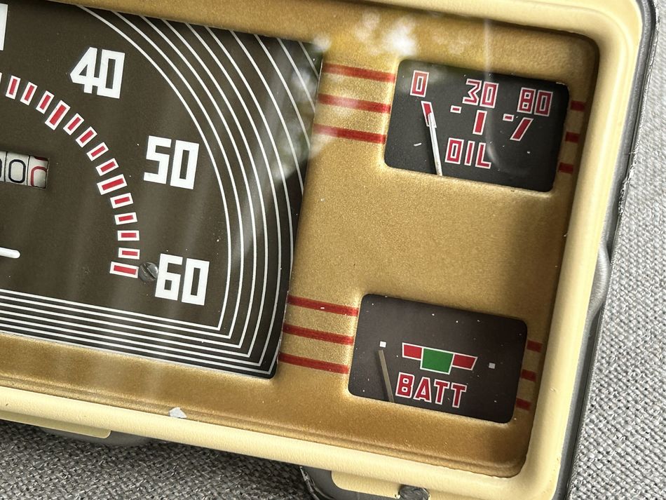

Those guages were used in Canadian Military trucks thru '42, before the military type was adapted. My CMP '42 uses a civilian type truck gage. Newc
Yes, you are correct.
As you will know from 19Fordy, in Ford Trucks the BATT gauges was replaced starting 1941 (end of 1940?) with an AMP gauge. In he CMP however this was not the case.
The CMP clusters continued to use the BATT gauge until the clusters were changed in what you call the military type (round gauges and speedometers).
This changeover (to round separate gauges ) took place in 1943 however (I think ...).
The pictures show a 1942 cluster for CMP (restored by me). Note the BATT gauge and the Tacoma Cream bezel.
Greetings
Hans
