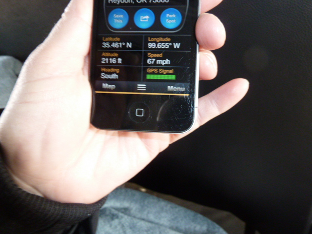

I was in the same bus as Derek and my Dad
Only pic I got was 67mph on a smartphone but I remember we certainly beat 70mph and believe Derek to be correct that 74 was best we saw on a slight downhill gradient
Weighed it with all passengers after
All this on private road, experienced driver no other traffic and consenting adults involved
Ran straight and true
