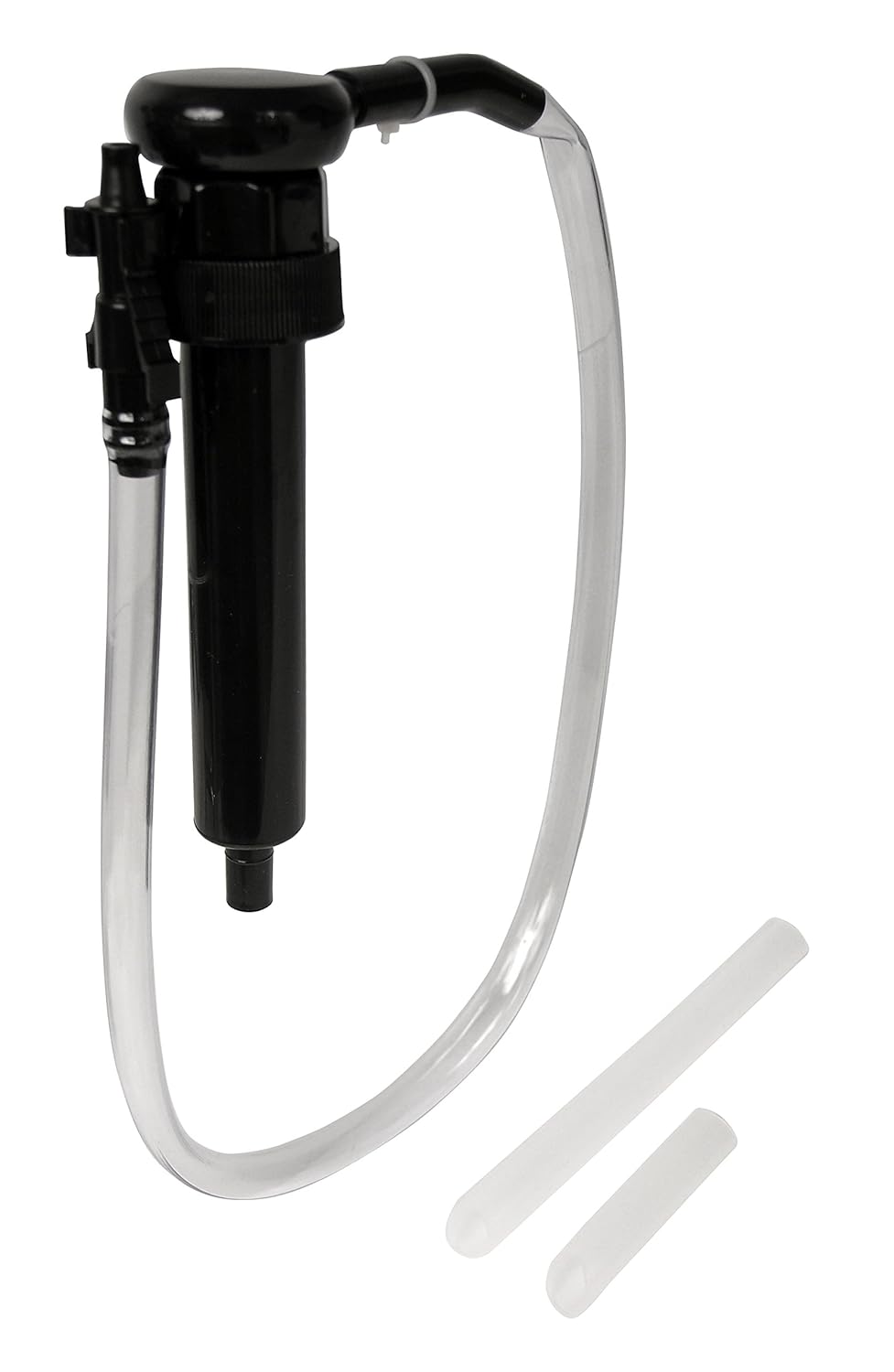

I bought a pump from Amazon with my one galloon Stalube GL4 gear oil. It's about $10.

I posted a URL with the Amazon Link. Click on it to go there. The one I bought is a 36671 Pennzoil Fluid Transfer Pump. I only used it once so far, so I can't say how long it might last. It is all plastic, so not all that sturdy, but you are only pumping a little gear oil.

I have one of the pictured pumps and as stated above, it doesn't reach down far enough into the container.
