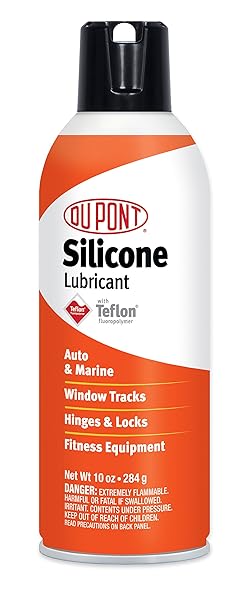

Amazon, $6

I would not use silicone anywhere around my car or shop.

Is that because of the potential for future paint adhesion issues? Otherwise, silicone is great lubricant when used correctly.
