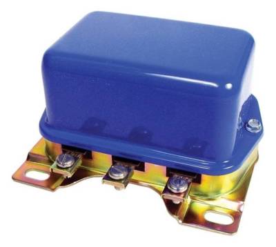

Hi guys i am looking for a possibly made in the USA 6V voltage regulator with four posts as in the pic for my 41 ford coupe . I don’t want re pop stuff but something made here of sound and not questionable quality . Any one know of where said item might be? Thanks so much

Most if not all made new today doesn´t have the grounding screw...you have too hook up the ground to one of the mounting bolts.

Just got one from NAPA a couple of months ago. It is three lug Echlin but as mentioned the ground is through the mount. Made in USA.

I see old originals on flea-pay now and then. They were rebuildable back in those days. A person would need to find a good auto electric shop to have it tested prior to use. They were also made to be adjusted more easily than any of the new stuff. It's well worth looking around. NOS parts may be out there but I would still have one checked out before trying to use it. The ones with the extra ground terminal are getting harder to find and can get pricey.

The old three pole units had a pretty good buzz to them when they were in operation so they set them up to be mounted with rubber vibration isolator cushions. This meant that they would have to be grounded in a different way so they added a grounding terminal. They used these up into the early 50s but they all went to a straight solid mounting after that. The 1941 Ford cars would have had the 01A-10505-C regulator originally. It could have been replaced by a 51A-10505-A or an 8A-10505-A over the years. All of them are good units.

B5 indicates that to be designed during the 1955 model year. It was likely the last of the 6-volt types. 1956 is when they went to 12-volts. The amperage rating is important too. Most of the old 3-pole type were 33 amp max.
Just to add: I looked and the Echlin Catalog and they list the VR401 as the replacement for a lot of the 3-pole 6-volt system regulators that Ford and some other manufacturers can use. Echlin used to be a good quality outfit but I can't vouch for them since they were bought out by Standard Motor Parts. The VR401 uses light blue for the cover. Here is a NAPA link.
https://www.napaonline.com/en/p/ECHVR401

I just bought one of these from NAPA FOR A '39. Echlin made in USA. The blue color is "Echlin Blue. Installed and working great.
