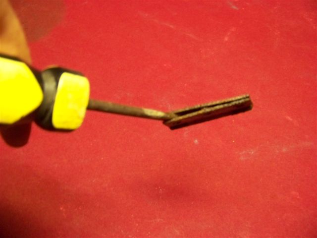

Here are two real rusty things I have been soaking (as an experiment)
for a VERY Long time, the nut and bolt, (three years) and the little hinge
for over a year now.
The acetone does NOT mix with atf for very long, they separate.
And the acetone evaporates pretty quick, so you have to keep adding
acetone and I have had the nut and bolt in a glass jar with lid, and I
have been shaking it up to keep it mixed together untill I got sick of
doing that, so the nut and bolt has been soaking for at least 3 years.
I take it out a couple time a year an use my air guns on it, and
it has Never budged at all.
Even my rusty little hinge is still stuck tighter than Jack Benny, even
after over a year of soaking in that junk. My experiment says it's Junk.
Click on pics to Enlarge
If mama ain't happy, ain't nobody happy.

Hello Denny, i don't have any Evaporust, or I would sure try some.
I thought that little hinge would have derusted some, but as you
can see, I pounded a screw driver in it, and it still won't budge.
I will have to see about getting some Evaporust to experiment with.
