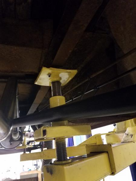

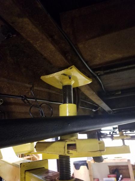

Lift points I use. With extenders that came with the lift.

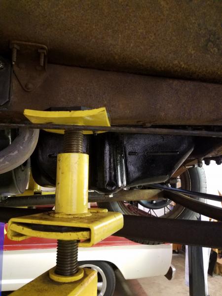

I for sure would NOT want to be under that where you have in your third picture, way too far forward on the lift and completely unsafe. As others have said use close to rear motor mounts for front and closer to rear on back utilizing the frame with spacers.

Originally Posted by Josh Randall View Post
Attachment 364443
Attachment 364444
Attachment 364445
Randall
That is one strange/scary set up for lifting with those extensions, yuck.
Why do you say that? There is 1-1/2" of thread engagement.
Show us how you do it.
Randall

I have people say the same thing about my setup.It does look scary,but when I put mine up a foot or so,I grab the car and shake and thrash it around,I can see it ain't going anywhere.Those extensions wouldn't be built and sold if they were a problem.I would like to put my front lift points on the A like you have them,ahead of the motor mounts.I can't on my lift because it is so wide I use up all my arm length swinging the arms in to meet the frame.
Josh, my set up is about identical to the photo that Bob C sent.
The only difference is I am using an Atlas lift and my lift isn't as beefy as Mitch's lift shown in the photo. The lift points are identical.
Looking at the lean in those extensions they must not be very rigid.
Mine are and without any sway.
Randall
