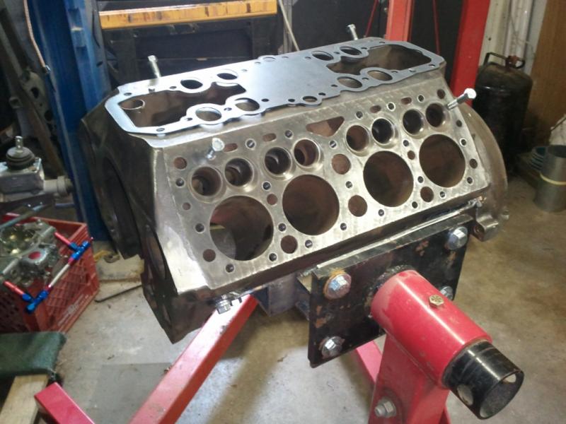

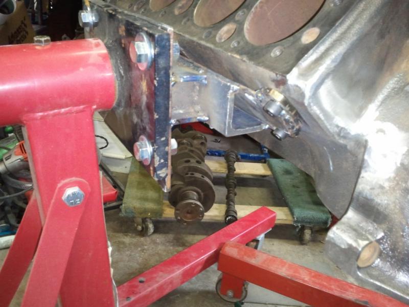

Old 10-26-2015, 10:16 AM   #10
JSeery
Member Emeritus
JSeery's Avatar
Join Date: Nov 2012
Location: Wichita KS
Posts: 16,132
Default Re: Engine stand
It is very easy to make (or have made) and exhaust mount. You can use a tube that matches your existing stand or make a flat plate adapter. The angle is 45 deg, an exhaust gasket or manifold will give you the bolt pattern.

Old 10-26-2015, 10:39 AM   #11
Bored&Stroked
Bored&Stroked's Avatar
Join Date: Jan 2011
Location: Central Ohio
Posts: 5,174
Originally Posted by V8COOPMAN View Post
Hard to convince most know-it-alls! DD
I think I'm going to be SICK after seeing that! And my guess - was using a wrench or breaker-bar to turn it over from the front of the crank. Nice way to apply even more pressure to that thinly cast bell in the back!
AND - that engine had a LOT of expensive stuff in it . . . and was probably ported/relieved as well. Yikes!
D

Old 10-26-2015, 03:16 PM   #13
V8COOPMAN
V8COOPMAN's Avatar
Posts: 11,127
Originally Posted by TDS View Post
Hi
Okay Im glad I asked - not an good idea.
Will make an adaptor.
Thanks
This is all you need, with the tube sized to replace the black parts on your stand. DD
Click Links Below __
T5 W/TORQUE TUBE
Old 10-26-2015, 04:13 PM   #14
alan
Join Date: Jul 2010
Location: UPSTATESC
Posts: 669
V8coopman--need to drill a hole for the stop otherwise you will not be able to position the block
alan is offline   Reply With Quote
