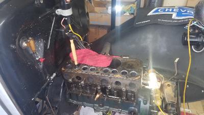

So, I pulled the head to change the gasket and inspect the cylinders. What I found was zero ridge except for cylinder 3 has just the SLIGHTEST hint of a ridge. Could be carbon. Pistons are .100 over, cylinder walls have NO cross hatching at all. So this is after 300 miles using 5 quarts of oil. Plugs should be a lot more fouled if it was burning that much IMO. The wife was following me the other day and said that it is smoking a bit. I'm thinking perhaps pulling the pistons, deglaze the cylinders, new rings and it should be good. Not convinced that all that oil when through the cylinders so must be leaking more than usual somewhere. Thoughts??.
[IMG][/IMG]
[IMG][/IMG]

First question, are the spark plugs in order from #1 (L) - #4 (R)?
My initial observation is oil is possibly coming from the valves. The fuel mixture appears to be close based on spark plug tips. The carbon appears to following the suite of the combustion chamber which would indicate to me that it is originating from valve guide area and not piston ring. Typically you see more even spread of carbon around the entire piston top when it is the oil rings that are worn.
To totally diagnose this, it would be better to see the margin of the valves, the seat surface, check concentricity, and valve stem to guide clearance. I would also like to measure the bore with a feeler gauge to see how loose the piston is in the bore, etc.

no the plugs are not in order. Another observation, the head mimics the pistons in that the combustion chambers are black/sooty with a little bit of carbon buildup and the flat area is shiny but all had a light coating of oil. Also the carbon was "wet" on the head right above where the buildup is on the pistons.

I pulled the valves. The guides were shot. I didn't take any measurements but they were quite sloppy. Without removing a piston, there is quite a bit of play at the top of the pistons side to side when I bring them up to the top. Not sure what to make of than as it seems to me that if the cylinders were wore it would show with a ridge at the top. Unless it was bored wrong or maybe this is normal for these engines, I don't know.

From a cost perspective the most expensive part of a rebuild is rod and main bearings,crankshaft and connecting rods.The cost of sleeving bores is up there too. Alot can be done to improve an engine that has decent rod and main bearings and minimal crankshaft thrust without getting too deep cost wise.In versely,a lot of time an money can be wasted trying to 'save' an engine with worn bearings..Engines need to be looked at as a whole,all processes must be in specification for long life,at .100 over with questionable bores and valves my next move would be a bearing inspection if it passes bearing inspection honing bores is a possibility if the bore measures correctly,lapping valves if the seats aren't too far gone,basically an old fashioned overhaul..

My thoughts exactly. I have already checked the bearings as i had the pan off when I first got it to fix an oil leak and checked/adjusted all the bearings at that time. If the crank/rods/bearings are good the rest can be rebuilt very cheap. For now, I'm going to do the valve guides and see what that does for me. I'm not going to be putting a whole pile of miles on this so putting it back to perfect is not necessary. I just need it serviceable/drivable in reasonable condition. I'll mic the bores and see what I have in that respect. Perhaps, like 30CCPU suggested, it's been bored to .125 but has .100 pistons??. If that turns out to be the case, it's not a big job to change the pistons/rings and deglaze the cylinders. FWIW, I did a compression check when I got it and they were all in the high 50's IIRC. It was definitely using oil through the guides though so I'l fix that first.
That is why I suspected & suggested worn guides.
Unless you have a decent selection of metrology, you are not going to be able to tell much regarding bore size and piston clearance.

There isnt anything bad about building the car to meet what you want. Guides are cheap,so are rings and lapping compound. No engine will tolerate a piston .025 smaller than the bore,your 'slugs match your jugs'..dont worry about being able to wiggle the piston some,wall clearance is way better loose than tight.You know what to do...good luck..

Licensed, get modern straight-stem valves and guides, they are made to tighter tolerances and will seal better and last longer. Use guides with the step, that looks like original guides, the spring will hold them in place.
John C, blow by is caused by gases blowing by the rings, not valves.
