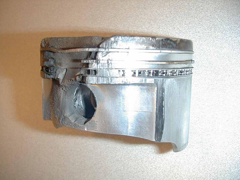

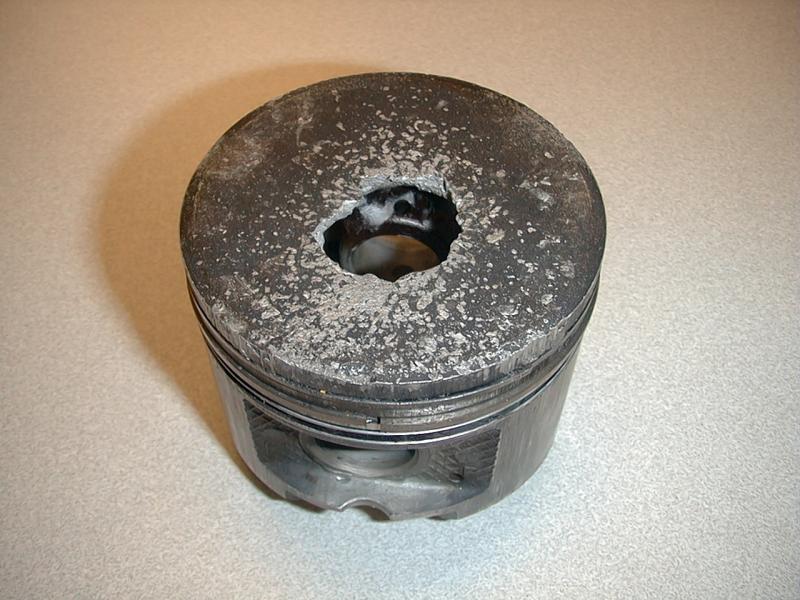

My Son and I own a 1929 82A pickup. We replaced the worn out 30A block with a 32B block, winfield head, brinley 3/4 cam, balanced crank, ansen down draft, demon carb and mallory centrifugal advance distributor, mallory coil - professionally built.
Now the mystery - at about 500 miles, driving from a car show the #4 piston fails (rod stripped of babbit, damage to piston skirt). Sounds like a cement mixer. This has happened now 4 times! The engine builder has been a real champ, standing behind his work, but the beautiful days with my Son end up in disappointment. (not to mention tow fees, pulling the engine, waiting for parts and the spector of engine failure each outing), I really need some help. Any ideas welcome. |

We have replaced the block (twice), all 4 pistons/rods/rings (3 times) and oil pump. The only things in common across all occurances are the head, intake, distributor, pan, tray, crank and cam. If it were detonation, would we see evidence on the piston head? Since it is always #4 could it be the crank/journal on #4? Could it always be #4 because oil starvation on the last cylinder? I appreciate guidance on a course of action (short of having my head examined - again ;-)... Chris |

OK....leaking needle an seat in the carb, peculation of the fuel after shutting the
engine down, hydrostatic locking of the #4 cyl. Electric fuel pump? Really not much info on the rod and piston, what does it look like, photos? Dudley |

The engine is back and running fine. The diagnosis was to little piston/head clearance. Another 40/1000 off the pistons and we will update you in 400 miles. |

First car show of the year, beautiful day, everything running great (oil pressure & water temp fine) and driving 45-55 mph, got 75 miles away from home and catastrophic failure.
Babbit hammered off of rod #4. - Same as before Since the last post, we installed a stock model b head, added electronic ignition to the mallory distributor and replaced the demon with a stromberg 97 carb. So we reduced the compression, eliminated timing variations and reduced fuel volume. The only things that are the same are the cam, crank and the driver. And the driver is becoming a crank ;-) I suspect the crankshaft. Could it be in the drive line some where? If so where should I look? |

It sure seems like you have a crank problem.. You don't appear to be getting any damage to the piston top so it doesn't seem to me that you're having an ignition problem.. What does the babbitt or journal look like??
