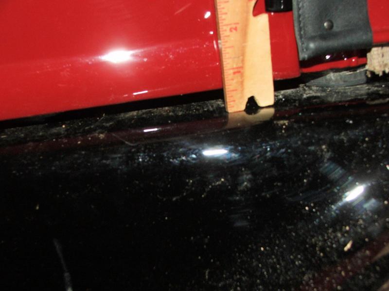

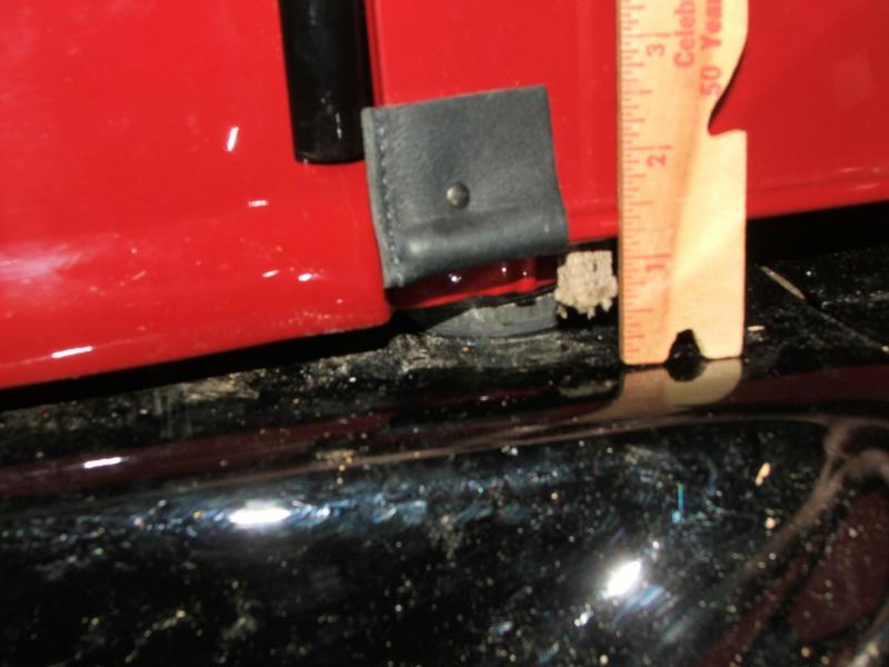

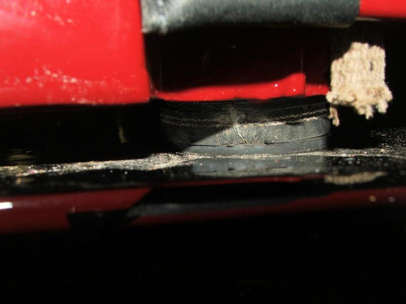

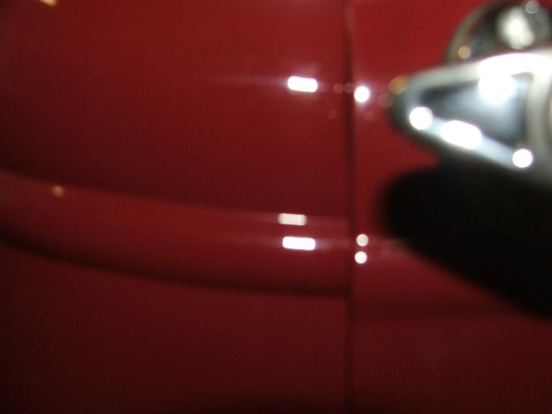

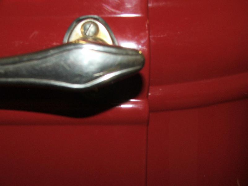

I am at the restoration stage of aligning the doors and hood on my 1930 Model A CCPU.
I have researched the Fordbarn and other Model A Forum archives, as well as many of the resources available to me, including Marco’s “Door Alignment” section in “The Model ‘A’ Barnyard”, Les Andrews “Model A Ford Mechanics Handbook – Volume II”, and THE RESTORER's “How to Restore Your Model A – Volume 2".
After numerous attempts, I now have the firewall hood welting frame perpendicular to the fender apron. As a result the passenger door appears to be close in alignment, with body lines on the cab and on the passenger door about lining up. Not quite so on the driver side, as the door has a rear sag showing, and the body lines on the cab and on the driver door not lining up. See pictures.
At the start of the restoration process, I replaced the frame that came with and was under the cab with an original 1930 frame. Based on the number stamped on the frame that came with the pickup, the frame was a 1929 frame. However, the cab appeared to be a 1930 cab. I had the 1930 frame check for straightness and sagging by having it checked by an auto body shop and myself.
So what is the problem – in order to achieve the current alignment, ie., getting the firewall hood welting frame perpendicular to the fender apron, I had to install additional rubber shims/spacers under the cowl. I have about 9/16” of rubber shims/spacers under the cowl, and only one(1) body block rubber pad under the rear of the cab. See pictures. This alignment creates a large gap between the front of the cab and the running board sections that sets on the frame, and a corresponding gap between the bottom of the hood and the fender shelf. See pictures. As a result, I am not able to latch the rear hood latches.
I am unable to get the radiator shell perpendicular to the fender apron. I have adjusted the radiator support rods to obtain the 31-3/8” measurement from the base of the cowl band at the front edge of the cowl band to the base of the radiator shell at the hood edge.
Finally, I have installed an additional radiator mounting pad under each side of the radiator.
I believe the hood alignment to the cowl and radiator shell is getting close to being correct. However, the gap spacing between the bottom of the hood sides and the fender apron is not acceptable to me. So, I am hoping to get some ideas as to what I should do next or undo.
What is the first thing a person should do when aligning the hood and doors? If I understand correctly, is getting the firewall welting frame perpendicular to the fender apron one of the first priorities? What then would the next step(s) to take. I just do not know where to go from here. I really would like to reduce the body shimming to no less than 3/16", and no more than 3/8" at any of the body bolts. I am aware this process requires understanding, finesse and patience. I would apprciate any comments/suggestions to assist me.

Here are my thoughts on the problem.
Forget about your hood and radiator for a minute and see if you can get your cab/doors aligned first.
If you straightend your frame with the engine out, check it again after the engine has been installed to make sure nothing has changed.
Assuming your frame is straight, I would check and try these things -
1. Make sure your hinge pins are tight in each hinge.
2. Make sure your hinges are tight where they attach to the doors, and to the door jam. (You should be able to open the door a few inches and then test it by pulling up and down without any noticeable play in the hinges).
3. Make sure the hinges are not bent out of shape causing the door to sag up or down.
4. Make sure the space between the front of the door and the jam is even for the full length of the door.
Shimming the cab -
Put an even amount of shims under each body bolt mounting area.
What does the cab look like at this point?
If the doors sag at the latch area, add shims to the bolts at the rear of the cowl but not the front of the cowl. Add shims until the reveals line up at the rear of the door and cab.
If the doors are too high at the latch area, add shims to the front of the cowl to line up the reveal. You could also add shims at the rear cab bolts for this problem. If you add shims to the rear of the cab, keep in mind that you will probably want an equal amount of shims on each rear bolt. If you have shims on one side and not the other the cab may look misaligned with the pickup bed.
Think of your cowl as the main aligning factor for the cab and doors. You will be tilting the cowl assembly forward or aft with shims which will cause the rear of the doors to raise up or lower relative to the rear of the cab.
Just as a note, I had an unusual problem with my cab. One side lined up fine and the other side would not line up with the same amount of shims. It took me some time to figure it out but it was a problem with my subframe. Turns out that the subframe had been cracked and welded at some point in the past. It was welded in a way that obstructed a correct alignment between the cowl and the rear of the cab on that side. I was able to bend the subframe a little on that side and then everything lined up correctly with the body bolts and shims.
After you get your cab/doors aligned properly you can start lining up the hood and radiator. You will probably want to start that process with standard thickness shims under the radiator. Take a look at the hood fit and then raise, lower, and tilt the radiator fore and aft as necessary.
You said you now have a 30 frame so it should have the proper crossmember with the lower radiator mounting points. However, if it seems that you can't get the radiator low enough for the hood to align properly it will then be necessary to install an equal thickness of shims under all of the body bolt mounting areas. This will raise the cab equally and maintain the door adjustment you just achieved.
That should give you some more ideas to work with.
