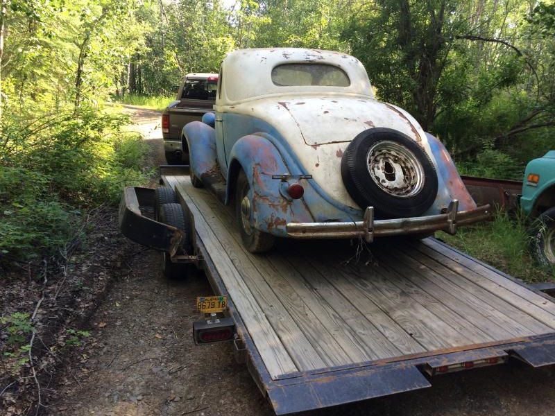

Hmmmm, this means my 35 three window must have a 36 spare tire mount. As somewhere along the line it was converted to 1939 hydraulic brakes and wide five wheels. The spare is also a wide five.

Beauty!

Here is an enlarged picture of the three window coupe in question. It is hard to pick out what kind of Spare Tyre Mount is fitted? It seems that a lot of body colour is visible? Is it just attached by a single bolt on the 35 Bracket mounted upside down? Really need a closer shot of the spare wheel and mount. |

Apparently I need a new mount, once I pulled the hubcap I noticed this. It has a home made plate welded on top of the old mount.

Love the Desoto rear bumper! I believe my rear bumper is off a 41 Ford(not sure).
So David, is there a positive way to tell the coupe rear tire mount from the sedan, etc? Like a part, or casting number? I saw one for sale in classifieds, but want to be sure it's the right one. |
